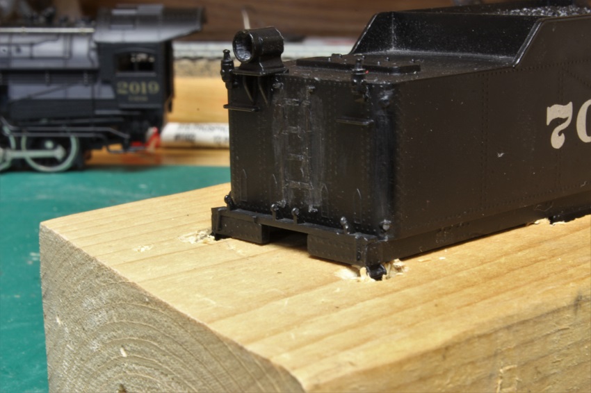

For today I have some more pics of my I-10's tender build.
A shot of the rear with the ladder removed.

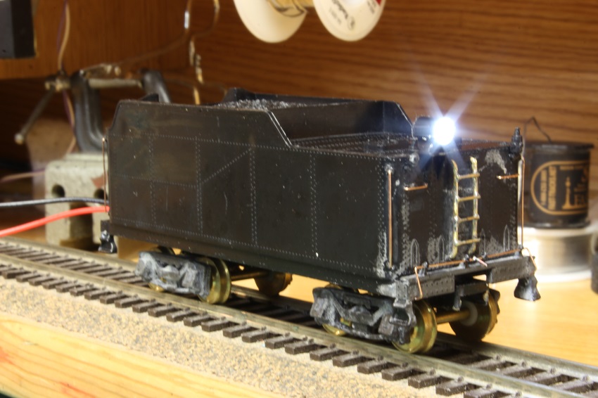

And one with the new details installed. I also removed and replaced the molded on grabs and striped the paint.

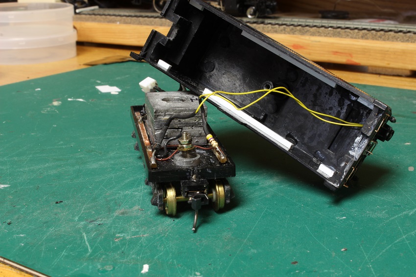

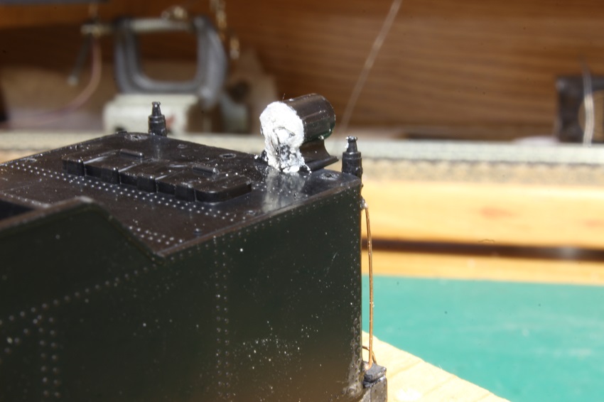

I squeezed a LED into the backup light after I insulated the leads. The back was then sealed up some putty, I'll sand it smooth latter.
All wired up and tested.

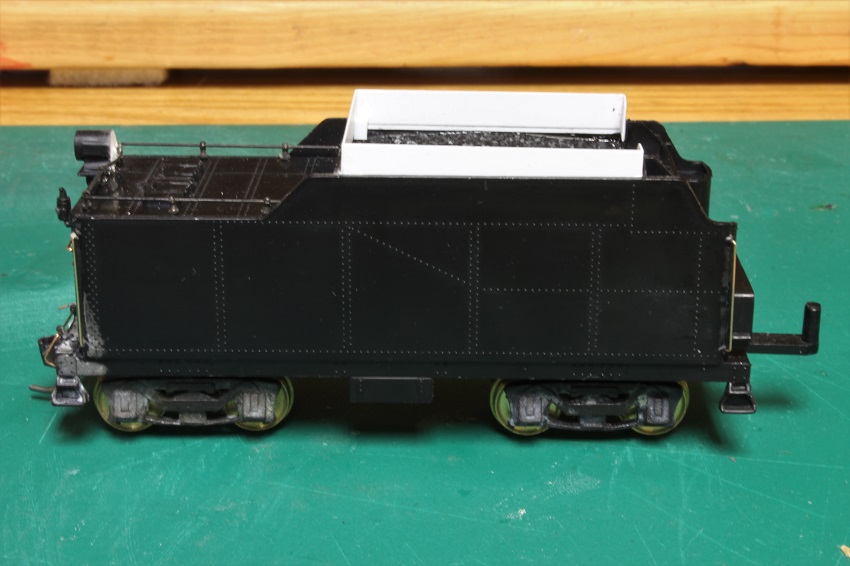

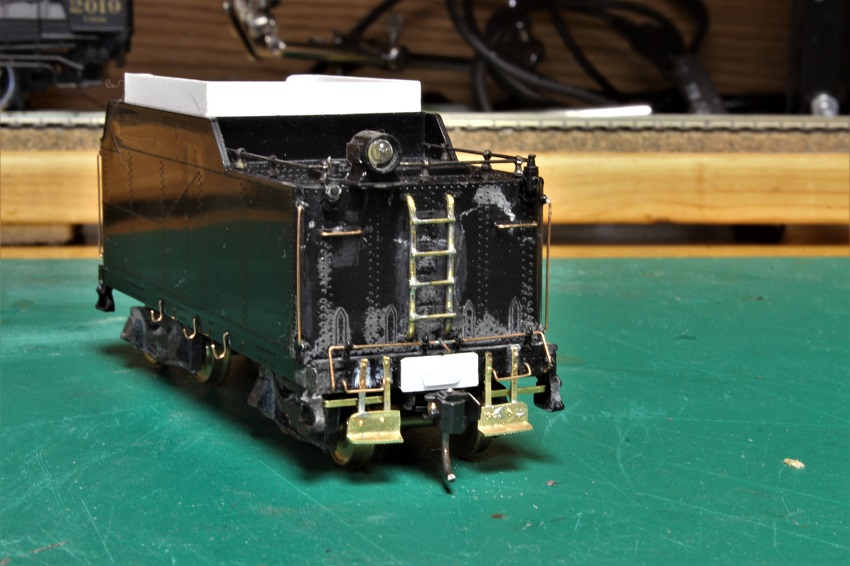

I had to add a lip to the inside of the tender to get it to set correctly on the frame.
The factory grab was reinstalled along the cistern, steps added to the end beam, chain hooks on the side sill, a buffer, and coal boards added
For now I am going to leave the factory draw bar on the tender until I have the drive running and boiler attached. I want to see what kind of room I have to work with on the converted model before I cut it off. I will called the build portion of this tender complete, she is pretty much ready for primer and paint. I will start another thread on the loco build, as this one is for tenders only. Big Grin
#48
Tender looks pretty sweet, Steve Thumbsup . Did you make that ladder? Can't wait for locomotive build. The I-10 could be choice of mine if the forum does another build challenge.

Yes sir. That ladder was built from some brass wire soldered together.

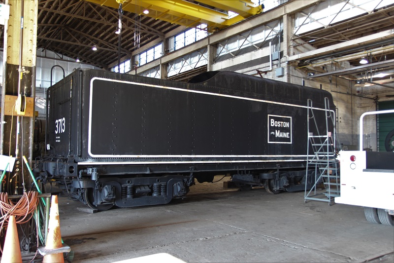

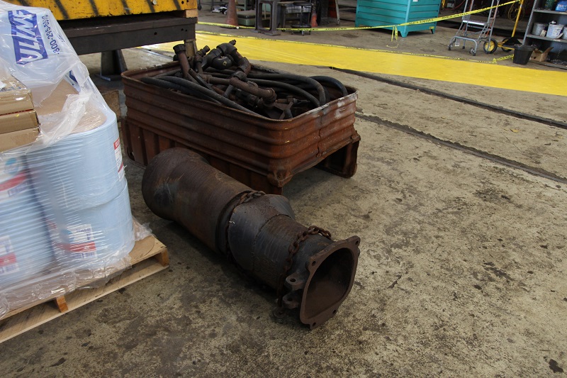

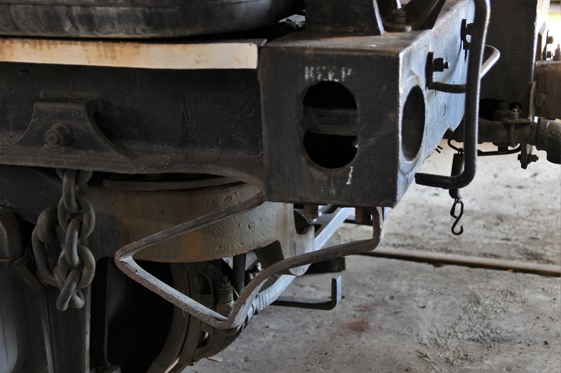

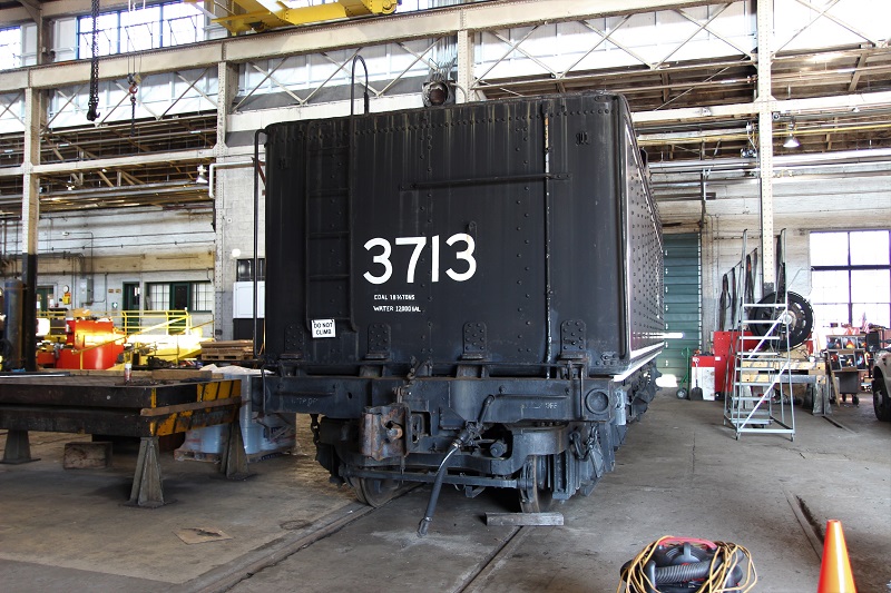

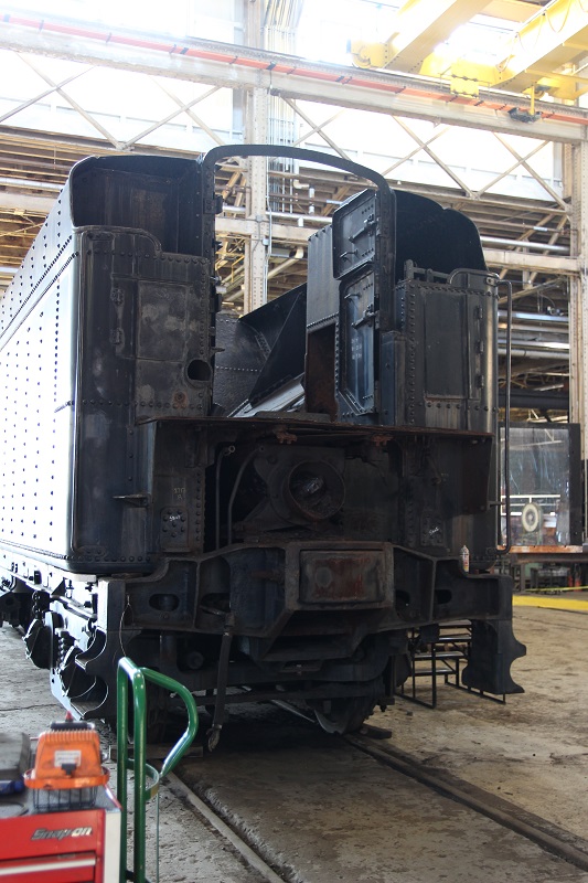

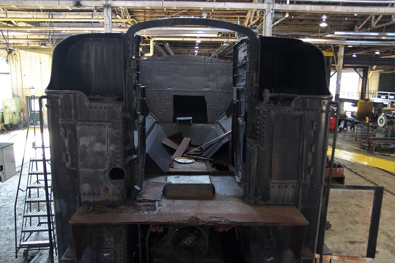

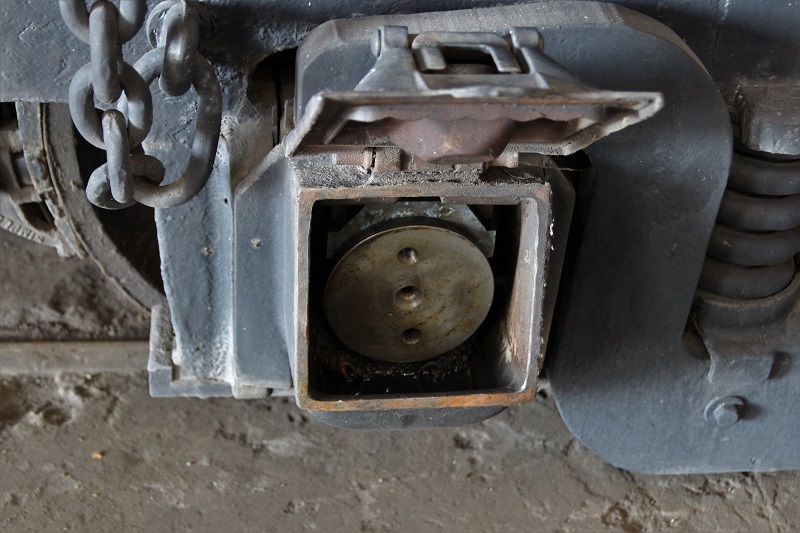

For today I have some prototype pics to show, It's the tender for Boston & Main 3713. This tender and engine are currently undergoing a projected 5 to 7 year restoration at Steamtown in Scranton PA.
The cistern is currently being removed from the frame as it will be shipped out to another location for it's rebuild. Everything from the frame down will be refurbished on site. One of the items to be addressed will be removing the old friction bearings and replacing them with roller bearings that will be hidden inside the journal boxes.
You can see that over the years she has been bumped around a bit,, All of this will be addressed.
The Stoker engine has been removed and packaged up somewhere that I could not find. I wanted to locate it for a few photos, as I intend to do a bit on stokers for this thread. But, no luck :? In the pic live steam feed pipe is visible in the bottom center of the stoker compartment.
The plexiglass window will be removed from the door and replaced with a steal one.

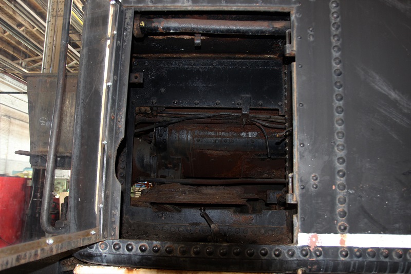

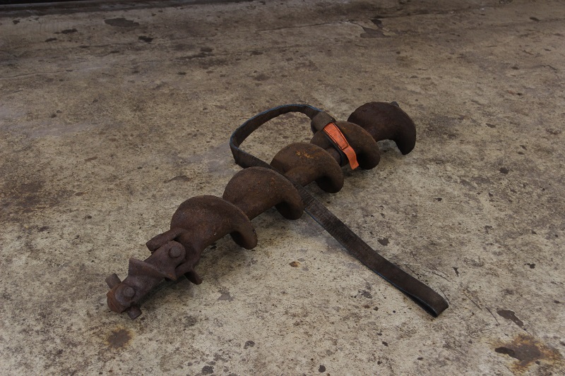

The rest of the stoker was easy enough to find as it's on the floor right next to it's tender.
It's actually in very good shape with just some surface rust that will be removed and the metal treaded with a rust inhibitor.
The business end of the fireman's office as also in very nice shape.
This shot gives you a good look at the coal bin. The cut out in the slope sheet was done some years ago for some unknown reason. That's another thing that will have to be fixed. This also gives you a nice look at the angled entry way into the stokers feed screw.

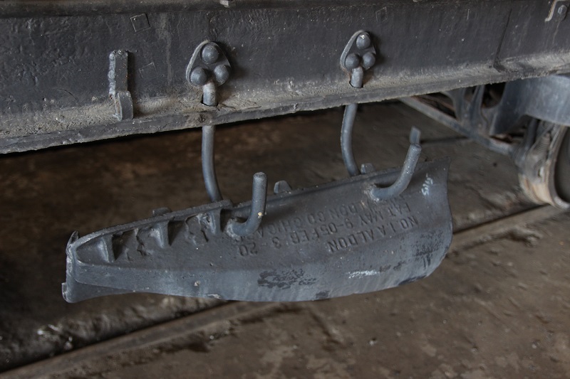

The rerailer was welded in place on the hooks to prevent theft :o :o :o :o . Will be making this functional as regrettably, we do use them from time to time.

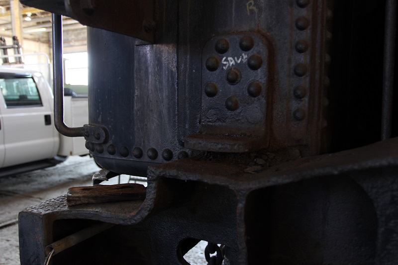

#52

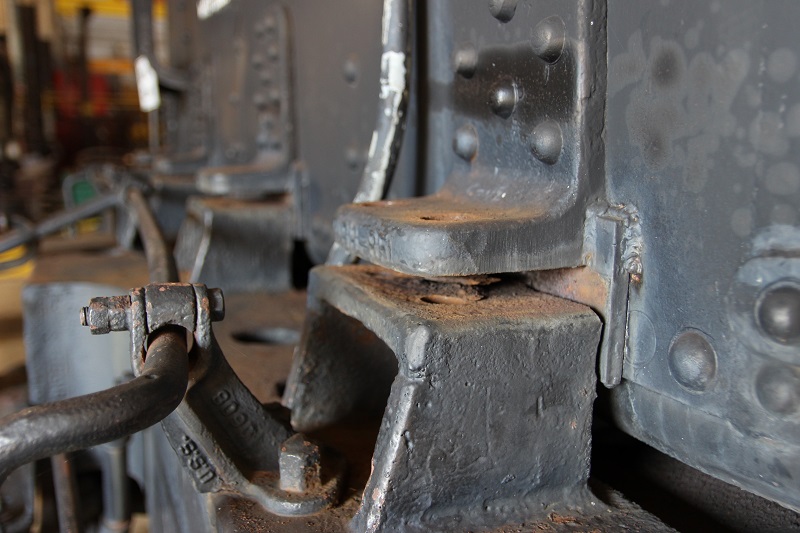

The bolts were drilled out of the brackets that holds the cistern to the frame and the wooden spacers removed. Soon the crane will do it's thing and pull the tank from the frame for shipment.

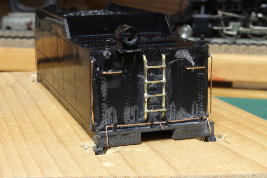

Here are a few tenders on which I'm currently working.

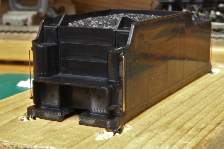

This one is a shortened Bachmann tender from ex-EG&E Consolidation 24, which was recently transferred to the Grand Valley.
The joint between the two sections here is quite evident, especially with the glossy finish, but I hope that with some rivet decals applied (hence the need for the high gloss) and an in-service paint job with appropriate lettering, she'll look a little more presentable...

Here's the preliminary application of the rivet decals, with more setting solution required...

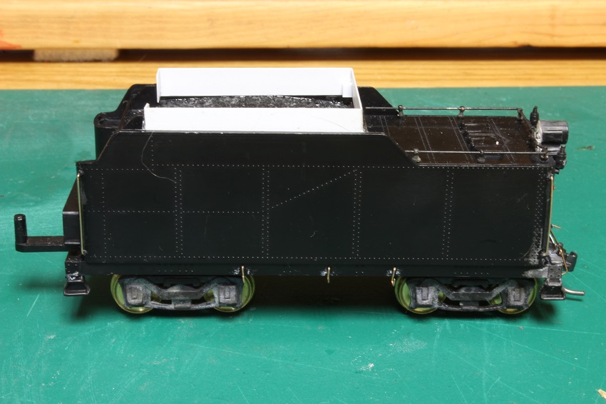

This tender is from a recently purchased brass model of a CNR 10-Wheeler. The previous owner has modified the coal bunker, but I can't find any prototype photos of CNR 10-Wheelers with a similar modification, and especially not for the loco for which the model was originally lettered....

These models were supplied with an optional oil tank which drops right into the existing coal bunker, just like was done with the prototypes, which originally served in western Canada. Many of these locos were later transferred east, and converted back to coal. I managed to remove the modification fairly easily....
[Image: LOCOMOTIVE%20TENDERS......%20007.jpg]
...along with the factory-installed box on the tender deck near the water hatch. This box was for chemicals added to the tender water to prevent foaming in the boiler due to the poor quality of water available in some areas of western Canada. The real ones lost the box, too, when they came east.

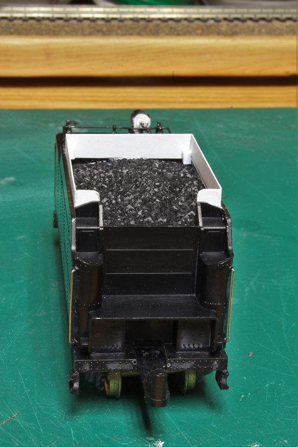

This tender, also from a loco recently acquired, has had its glued-in coal load removed, and will get at least a partially-modelled coal bunker. It's from a CNR Mogul, like the prototype one pictured in Ed's previous post.
[Image: LOCOMOTIVE%20TENDERS......%20009.jpg]
[Image: LOCOMOTIVE%20TENDERS......%20008.jpg]
