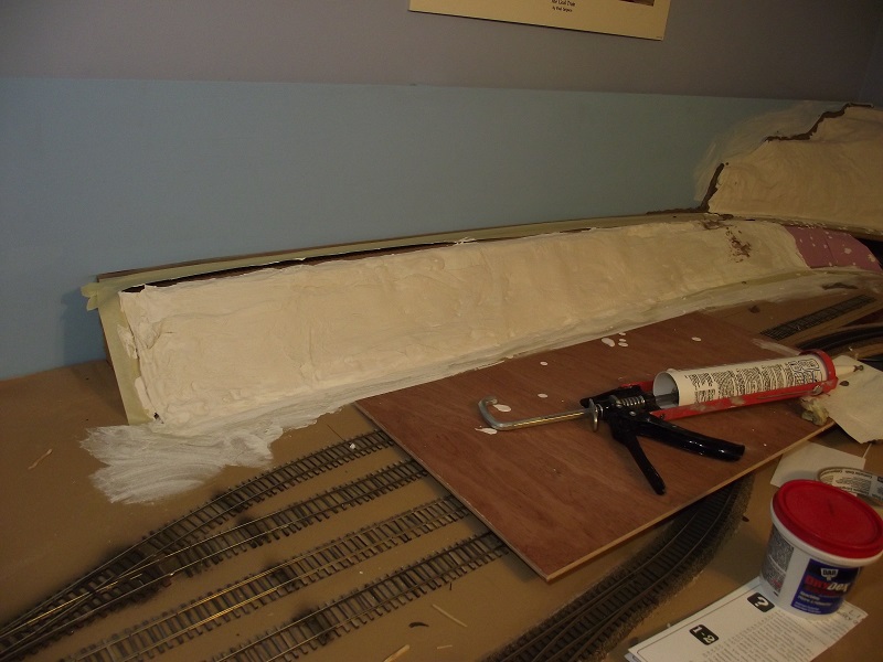

I did glue and staple the scenery forms in by the future town of meadows. Since I was using 1/8" plywood (also know as door skin) I was able to form it around the curves of the upper decking. now you can see the dimensions that I can work with to plan the townsite.
And I got the hardshell down on my corner mountain. It was a bit of a stretch to lean over and lay down hydrocal-soaked paper towels without making a mess (I failed on the mess part) but I need to get this part done and sceniced before I can proceed with any other scenery. The brown 'goo' around the edges is some mocha colored caulking that I used to seal the gaps between the hardshell and the backdrop. When its all dried I'll paint it in the same base tan before adding adding rock castings and ground cover.
While I was at it, I completed the hardshell on this slope as well. I'm learning these technics all over again since the last scenery of this type that I did was over 10 years ago.

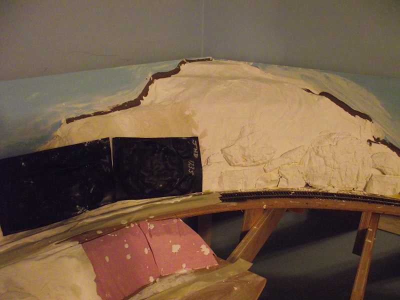

Thanks but I'm finding that I'm going through the same mistakes that I would have made back then, only remembering after I make them!
Case in point.
I started to add the rock castings when I found that I had made the mountainside too close to the track and had to pull half the mountain down to trim it back on one side. Then I re-hardshelled the area before I add the rock castings.
During this time I ran out of Hydrocal so I went to a nearby building supply dealer and picked up a 50lb. bag. That should be enough for the entire layout, plus some. I did have a strange thing happen when the first hardshell use of the new bag turned a light gray instead of white, my next application was white.
And this morning I mixed up some more plaster and blended in the castings to the mountain. Tomorrow I hope to start staining/coloring the rockwork. Any holes/gaps between the casting are going to be filled with bushes and other vegetation.
And these are the rock molds that I used, sorry for the mess. A member of our club passed away about 6 months ago and we inherited his scenery supplies which included almost 20 WS rock molds.
