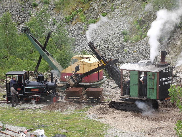

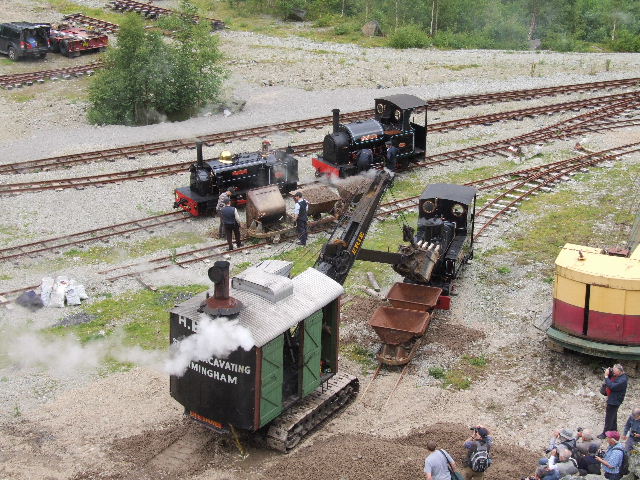

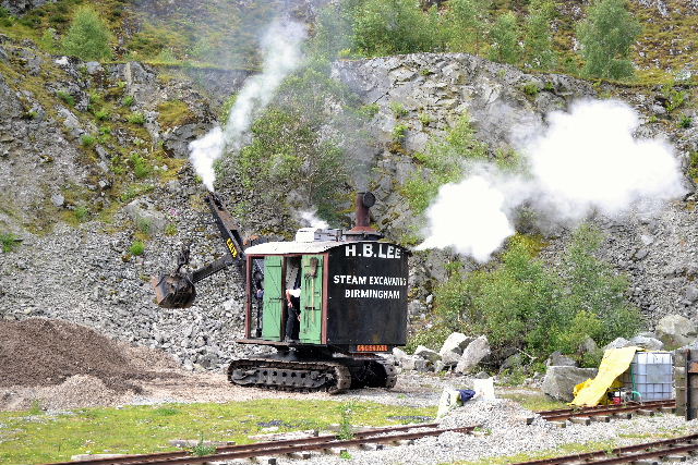

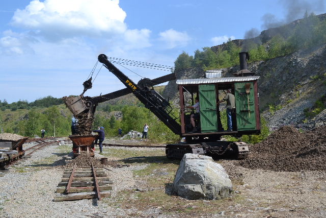

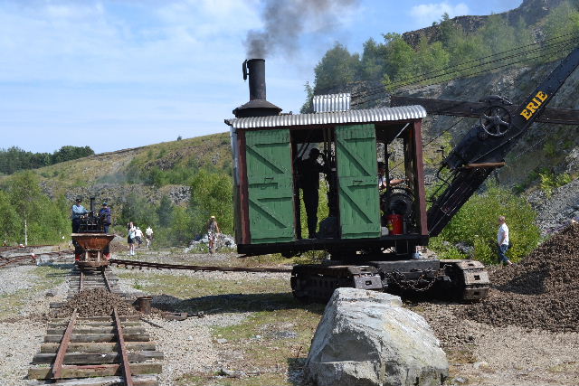

We had a Erie steam shovel at a local narrow gauge railway(in UK) , fascinating to watch, got a few photos from different angle somewhere if you need them.
Ray
Ray...that looks great!....if you have any pics you want to share....post away!

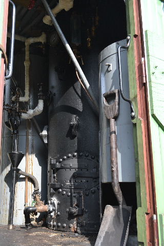

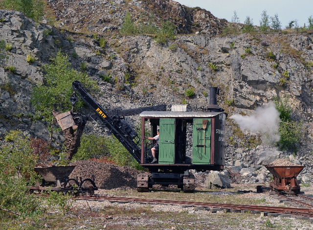

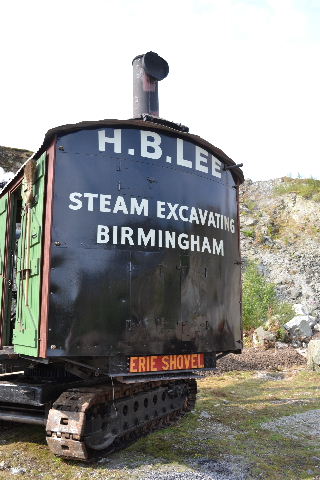

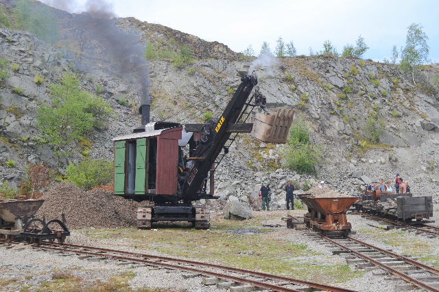

I tried to rustle up as many proto and model pics as I could. I found a modeled version of a steam shovel where the side panels/doors were left off (better to show off all the gears and boiler and such). That is what I'm planing to do. If I don't like it, I will add the sides later. Wink
Steve
Ray
hope these are of some help
Ray
Ray,
Thank you so much! Yes that will help alot. Thumbsup Thumbsup Thumbsup
