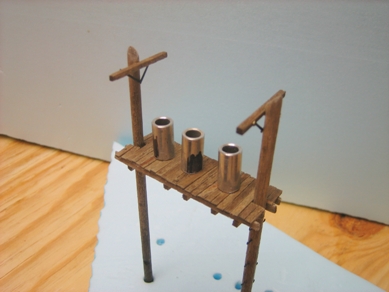

platform is finished, cross arms are on, and the x-formers are started.

Well now, that's MUCH better than goal posts! Thumbsup

Worship I apologize for coming in late.. but there is some fantastic builds here e-paw. the coal station and those tanks man, great detail and scratching, and I have been watching those goal posts grow into something else, what are you feeding them? 357

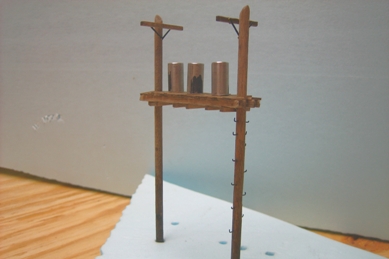

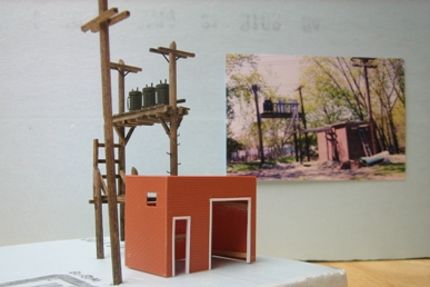

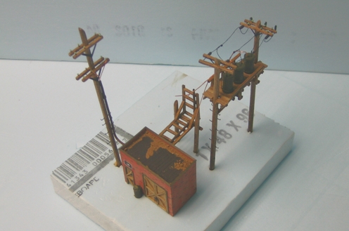

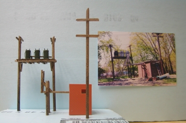

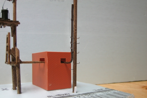

Did a little more work to the "goal posts'', and started the high voltage shed. Transformers are all done. In the background you can see a pic of the building that I am using for reference. I changed a few things but tried to keep the same feel.
#97

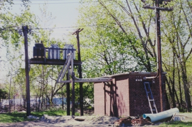

A better view of the same pic.

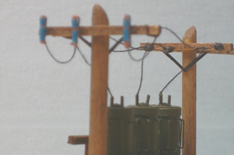

By the way I feed them N scale poles Big Grin
#98
Looks great..!! Thumbsup

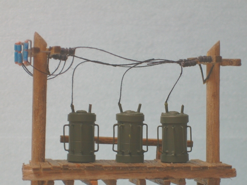

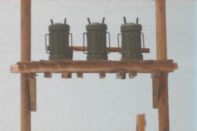

How did you make the transformers..?
Gus (LC&P).
#99
There just some aluminum tubing with music wire for the cooling pipes and the electrical taps. Also some .05 styrene as a band around the top and bottom. I tried to make older looking X-formers as opposed to the ones in the pic. The darker colored one on the prototype is from the early 80's and the other 2 were installed that day (about 2 years ago) after the high voltage shed flooded causing the switch gear to explode and catch fire. We replaced that and built the new -L- shaped rack that brings the 480 volt feed into the switchgear. the old flat rack can be seen leaning against the building. It was a good week for OT.

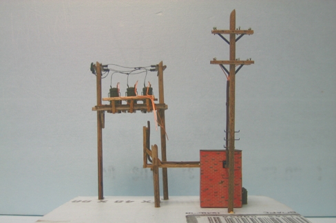

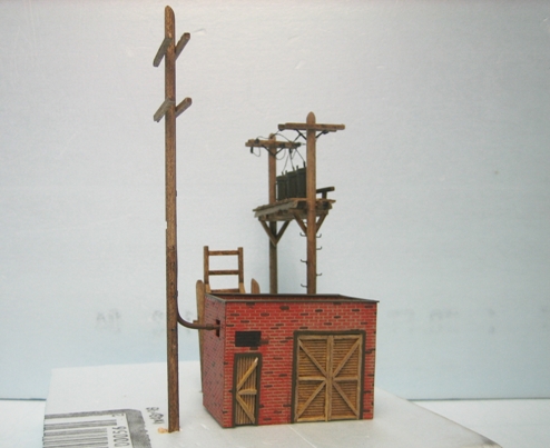

The primary side is wired. The insulators and fuses are in but need to be painted. Stepped the other pole and added the conduit that will feed the engine termial. This is taking longer to do in miniature than the real thing.
That is SO well done! Its going to be one of those detail scenes that people are going to stop and gawk at.
Started to paint and weather the shed, I'll try to do more tomorrow.
wow!
-Steven-

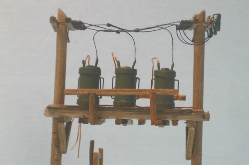

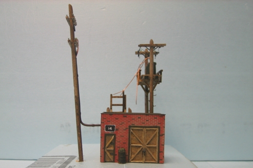

Almost finished Cheers . I have to let the glue dry before I paint the wire hanging off the X-former rack. Nore can I attach them until It's permanently mounted on the layout. Just a little bit more and it will be complete.
the rack
