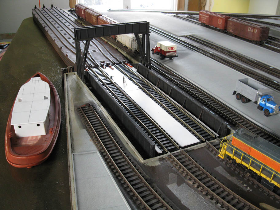

Lot of stuff happened during the last two days. I won't waste my time struggling with futile words so prepare yourself for many pictures.
[Image: IMG_8216b.jpg]
First, I painted the carfloat. After a basic coat of Krylon camouflage brown, I decided to try a method I once heard but never really applied. Instead of building the weathering pattern with several layers, I just used heavy washes of cheap acrylic paint including burnt umber, burnt sienna, Payne's grey and yellow ochre. Those water-based washes were really liquid and I dabbed and stippled thinned paint here and there. The idea was that those "floating" colors would merge together instead of drying. Some colors pool here and there. The nice thing is that the puddles leaves a very realistic weathering pattern. So far, I did the operation 3 times. I plan to lighten the overall color a little bit again with more drastic contrasts. I was once told in my teenage years that my drawing skills were good but that I was too shy to add light and shadows. Since then, I try to fight that natural tendency! With little success! Other weathering technics will be used, but I feel this technic is worth using. Very fool proof, no real talent needed, physic laws do the job for you.
