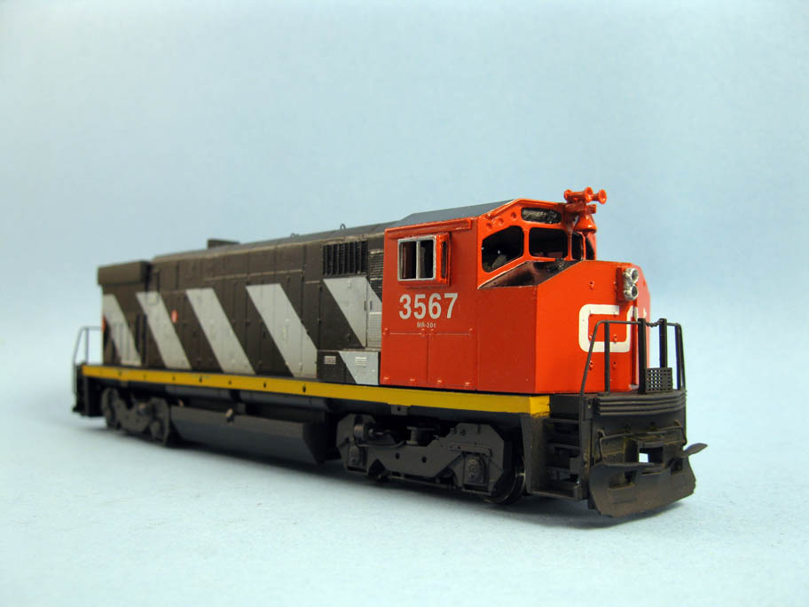

Some update. the unit is painted and about 90% decalled. I'm still trying to figure out how I'll assemble it, but it should be to hard to find out.
I'm not sure if it really looks like a M420, but at least, it looks like a MLW product!
Let's call it a perfect model for the 3 feet rule!
BTW, the roadnumber represent the unit that was wrecked in Charlevoix back in 1993 after hitting a rock slide and diving in the St. Lawrence river. Let's hope it won't happen (yet) on the layout!

You really turned that project around. Nice work

That unit is crying for some weathering. I hope that is in the works.

e-paw Wrote:That unit is crying for some weathering. I hope that is in the works.
Not yet, but that locomotive definitely won't stay clean for a long time. I'm thinking about a special treatment.
