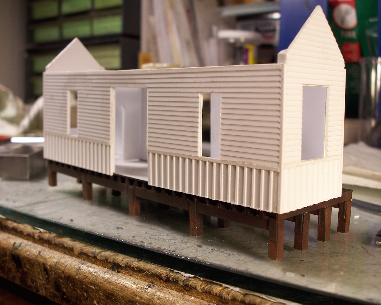

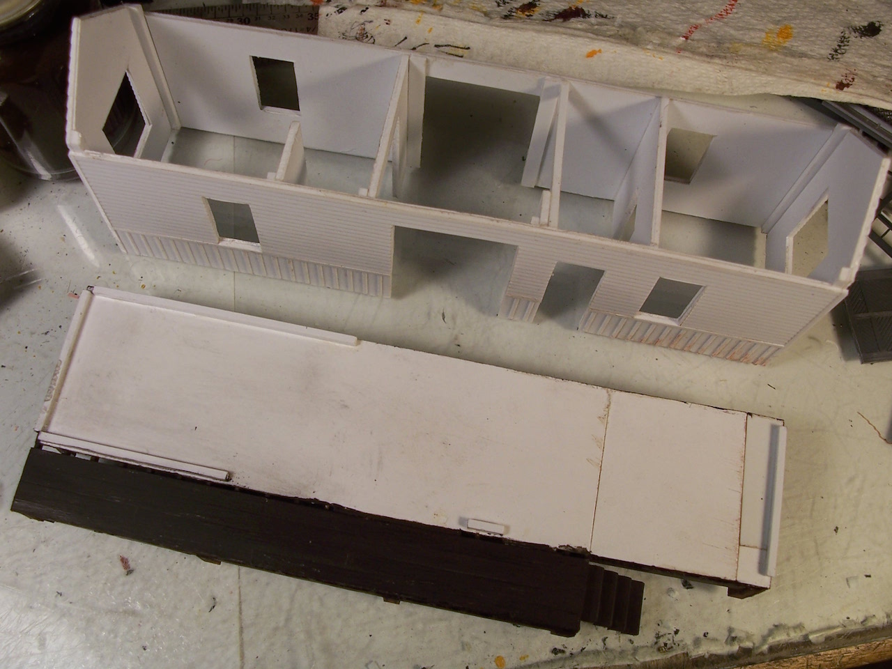

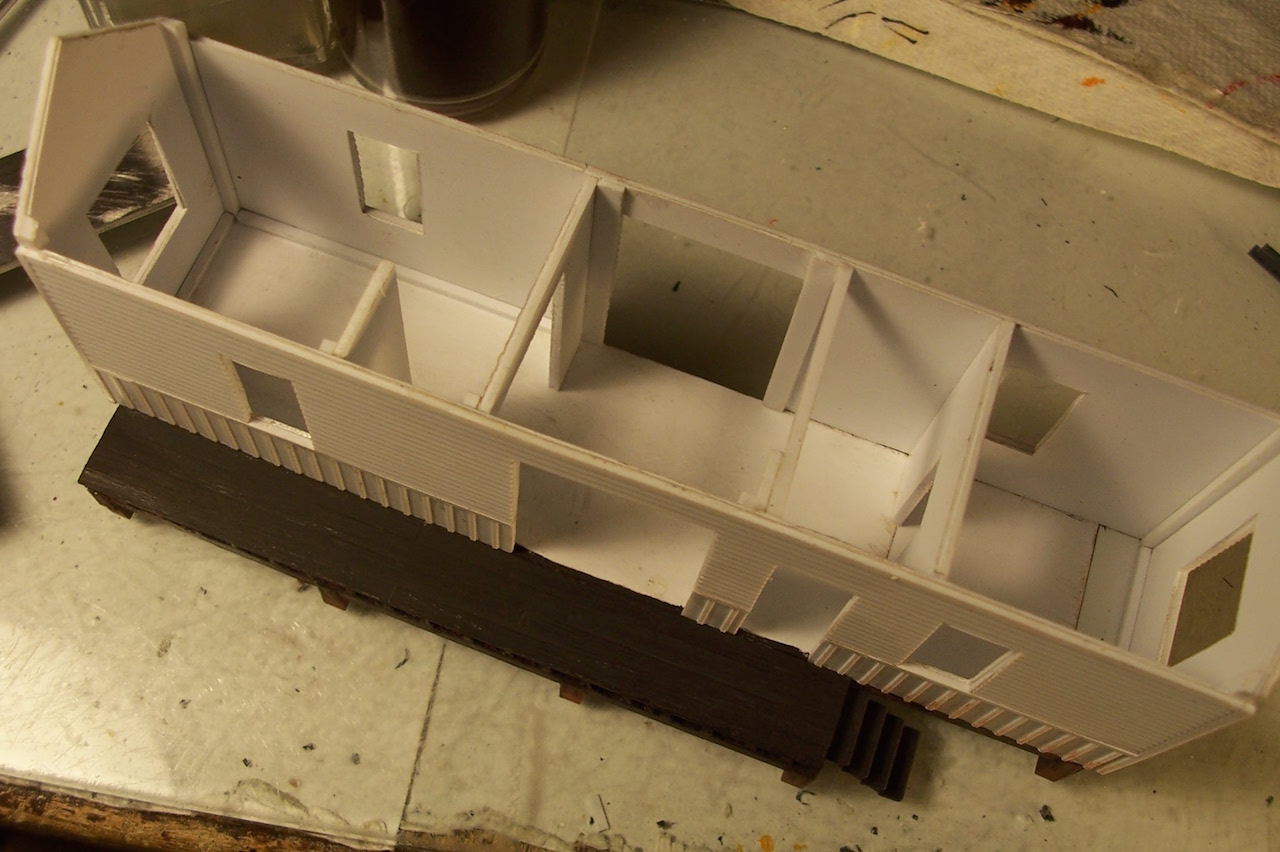

Here's the start of the warehouse, which is designed to snap-in-place onto its base...
...and installed on the base, showing the floorplan...
It was originally going to be all one room, but the walls are rather flimsy, so I added an interior liner of .020" sheet styrene, then decided that an office was needed for the agent, and also added a few semi-partitions in order to stiffen the walls.
I'll probably make a removeable roof, but will also leave the structure removeable from its base, as it will make any future interior work easier.  I do plan to make at least the freight doors operable...they'll be simple sliders, somewhat like those on a boxcar, but in the interior of the building.

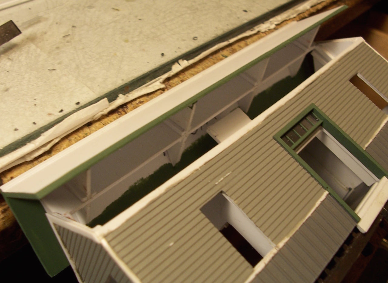

I had some issues with another scratchbuilt building where one of the gable ends warped quite severely inward, due to insufficient bracing, so I made the roof for this one so that it interlocks with the structure.
It's well-braced, with a deep ridge support, which slides between a pair of uprights cemented to the interior side of both gable ends.  Hopefully, the set-up is understandable from these two photos...

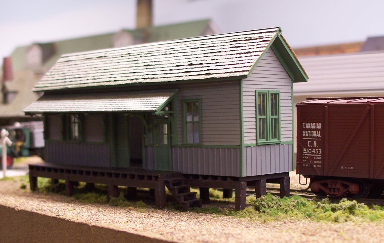

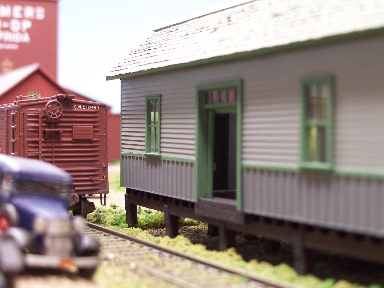

After that, I sorta got involved with working on this, and neglected to take in-progress photos, so here are a few views of it, temporarily on the layout where it will eventually end-up.
This side faces the track...
...while this side faces the access road and parking lot, although there's not much room for a truck to back-up to the loading platform...

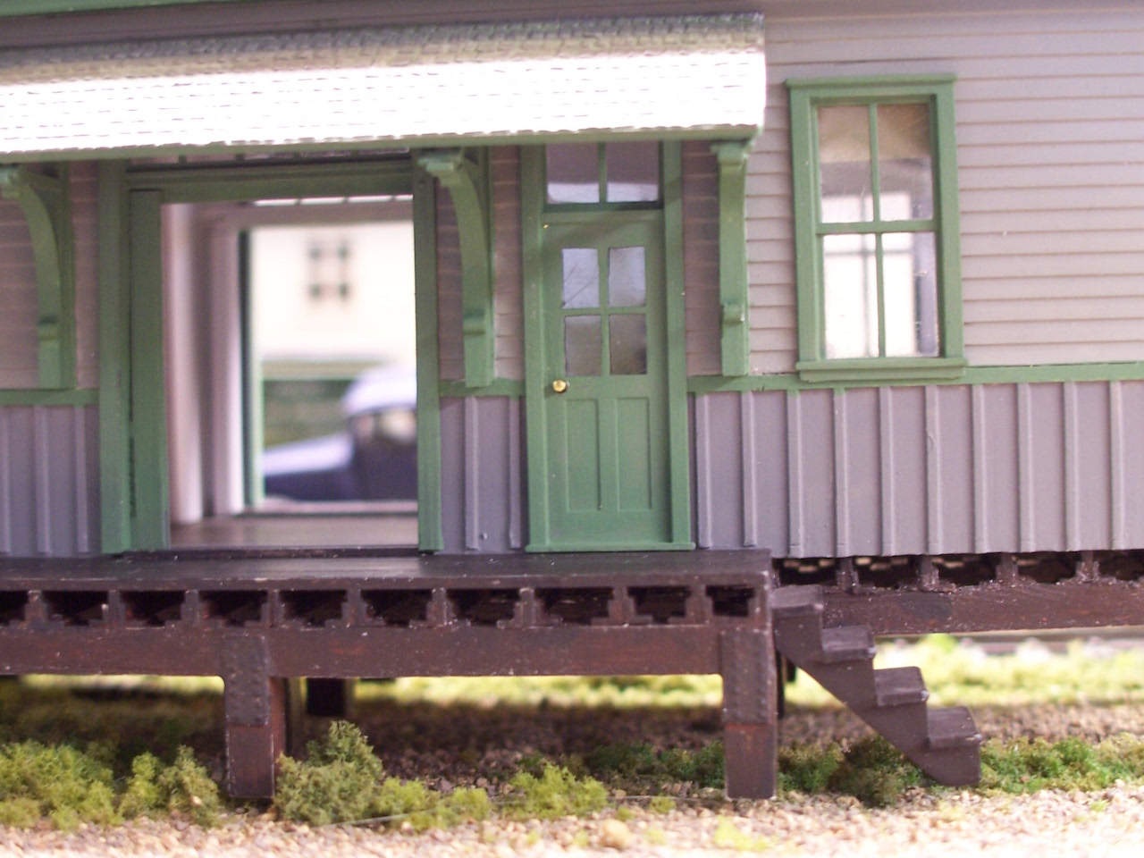

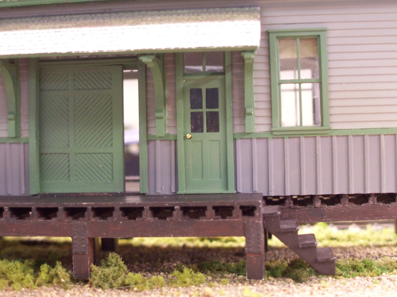

...a couple of views of the freight doors, with this one slightly open...
...and both front and rear doors open...
...and finally, a close-up of the brackets supporting the platform's overhanging roof...

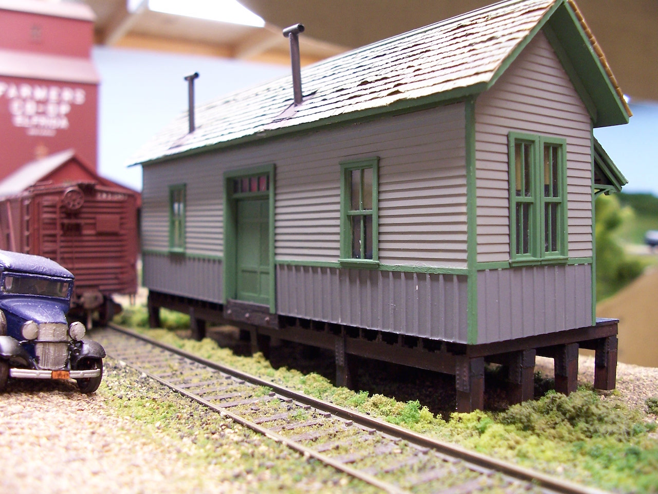

Here's the track-side view with the smokejacks installed...
Not sure when I'll get started on the next one.
#25
Looks right at home!
