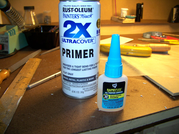

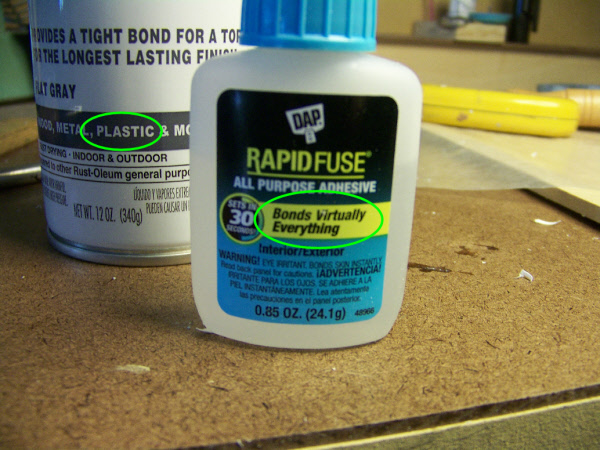

Went to Home Depot, what I have is indeed, PLAS-TEX®. I then went to the paint dept and asked them what was the best primer for plastic and she pointed out the "2X", even though it was cheaper ($3.98) than the others. I then spent an abnormal amount of time looking over their glue stock and decided on this one. This time it was the most expensive one ($5.47) for less than one ounce, but they say it sets in 30 seconds and cures in 30 minutes and bonds just about anything.
I put on my Dr. Nefario coat, goggles and gloves, found a few minions that were willing to help and proceeded to do some testing. The paint dries to the touch in 20 minutes and fully in 24 hours, but they recommend 5-7 days for maximum adhesion on plastic. Sorry Rust-Oleum, I have patience, but my minions start to get crazy after about two hours, so we'll start our experimenting with that in mind.

The results of my experiments:
Model cement did not adhere well, but the new glue worked fine. When they say, "Bonds virtually anything", they're not kidding, fingers, tools, working surfaces all joined as one now.
Moving on to the paint, acrylics scratched off easily without the primer. I sprayed the primer on a test piece and after two hours, it adhered just fine. Painting over the primer kept the acrylics from scratching or flaking, just that the darker grey bled through on most acrylics, even a white undercoat did not cure that completely. Either I use dark colors or try to find a lighter primer.
