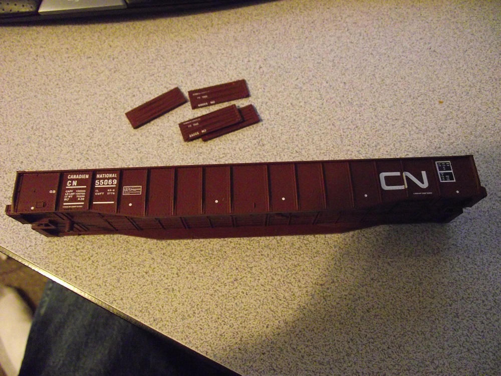

I just found this in a hobby shop yesterday for a very good price. However ALWAYS check the contents of the box:
Totally wrong era. Argh!
Fortunately, after checking my decal stash:
I can backdate it to my era of late fifties/early sixties.
My plan is to weather it very dirty and press it into tie hauling service.
It's soaking in a bath of 90% isopropyl alcohol right now.

Yes it is a Proto Gon, Wayne. This will be my 4th one built. Now that I've got a slightly larger layout under construction, I'm a bit more comfortable using longer cars.
I don't recall the kits sitting on shelves for long periods of time around here, but they can still be found at swap meets (If we ever get those again)
It took about an hour in Iso. Alcohol to strip the paint, another hour to assemble the kit.
I did have to open up the mounting holes just a bit so the grabs and stirups mounted a bit easier.
Last thing I did last night was to spray the primer. it will take a couple days before it cures enough to airbrush the oxide red color coat.

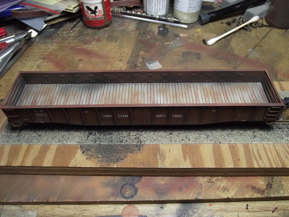

I weathered and installed the floor. It's a bit stark yet but that will change when I add an overspray of Polly-s dirt to tie the weathering colors together. So far it has a base coor of Krylon Paver gray, followed by drybrushings of a couple different gray acrylics. I used a very fine micron pen to mark the individual boards. Finally I drybrushed some oxide red to show the remnants of the original paint that was worn off by different loads over the years.
Before snapping the floor into place, I gave the inside walls of the gondola a light spray of Polly-s rust.

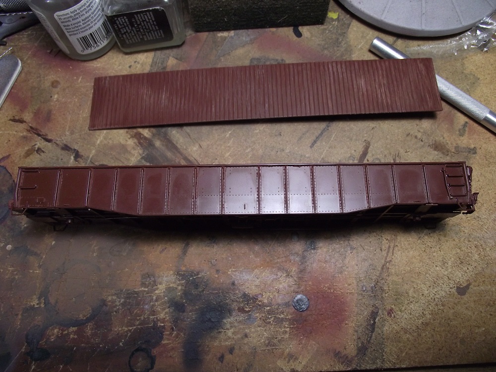

I finished off the gondola. I wanted to weather it fairly heavily so I went a slightly unconventional route. I found a similar technique on you tube that I followed.
I first gave the entire outside of the car a spray of grimey black. Not enough to cover completely but a decent overspray. at the same time I painted the trucks (less wheelsets) in the same grimey black.
Then I started to scrub the grimey black back off using a q-tip and Walthers Solvaset. I had tried this on a test piece using isopropyl alcohol but I found that the alcohol worked slower and turned the undercoat of dulcoat a milky white. For some reason I have 5-6 bottles of solvaset to I decided to try that instead.
It took a while but I liked how it turned out. the grimey black stayed in the corners and rivet lines where the q-tip couldn't reach and the rest of the car still had various levels of staining in the paint.
After that I sprayed the wheelsets rust and added the trucks onto the car. I gave the car and the trucks a very light spray of Polly-s dirt in some areas and called it done

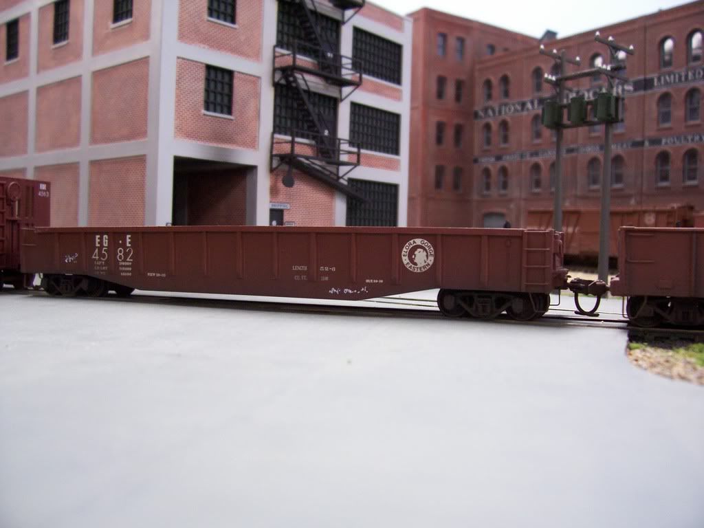

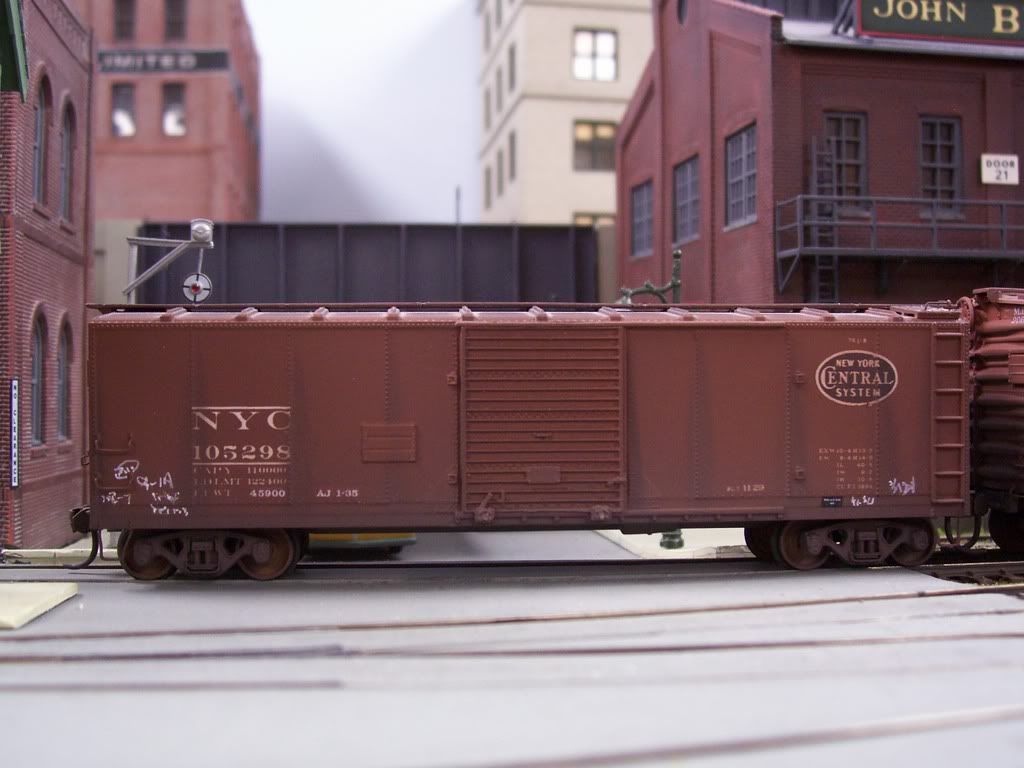

That's an interesting technique, Glen, and some good-looking results.

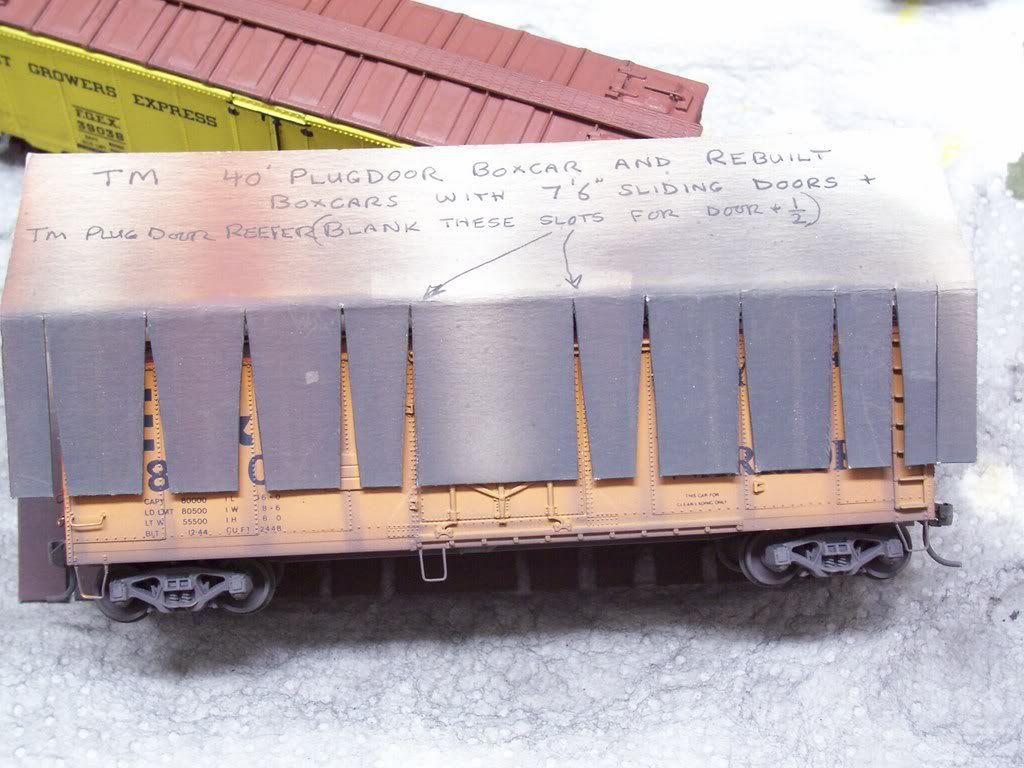

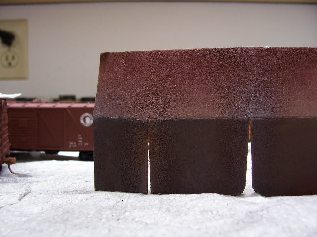

I used cardstock to make paint masks for weathering freight cars, and labelled them to ensure that I used the proper one for each particular type and maker of car...
[attachment=37113]
..and some results...
...while these were used for random weathering of details on many car-types and brands...
This one, made with sheet styrene, works on pretty-well any rolling stock or locomotive to create the effect of wheel-spray on the car's ends...
...like this...
Your technique is certainly better for creating the grime under the top chord of that gondola, where rain is unlikely to remove it, and alongside the upright bracing, too, as it allows you to remove, or leave, the amount of weathering that you want.

I like that idea, Wayne. I think I'd have to go with the non-specific Specific masks since my rolling stock is so varied that I'd only use one of your train miniature masks once or twice.
Posts: 5,859
Threads: 175
Yeah, I don't use the masks all that much anymore, but have them for several different makes and lengths of freight car models, as they're simply a quick way to add some weathering.
