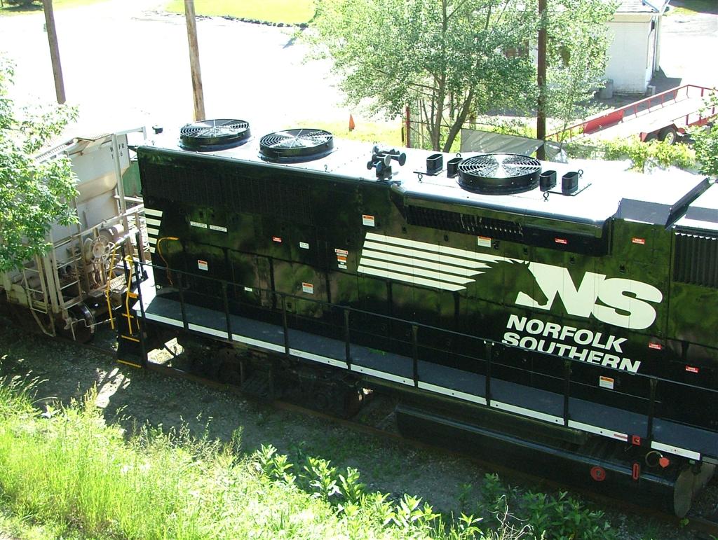

Mark, as a former autobody man I can tell you black is black. It was the only color that is /was the same for AMC, GMC, Ford, and Chrysler so you can't go wrong painting it high gloss black. Here are some pictures of the unit for our local fresh out of the shop.
The reason some NS locos look like they have a matte or satin finish is simply paint fade. Black, even gloss black, fades over time on something exposed to the elements most of their working lives like a locomotive is.

Holy cow you could shave in front of that unit! Now that's glossy!!! High gloss black it is! 2285_

That is nice.
Looks like all the top surfaces are painted some shade of gray, or is that just how the sun is hitting it?
NARA Member #87
I would say the top of the nose is anti-skid black, the rest is just the way the sun is hitting it.
-Dave
Puddlejumper Wrote:I would say the top of the nose is anti-skid black, the rest is just the way the sun is hitting it.
Dave is right on the money, it is a flat black to stop the glare, but the high hood GP30 would be all glossy. Everything but the top of the nose is gloss black. the sun has it washed out on the top. Too bad it is back lit, but the shots were out of our apartment window.
