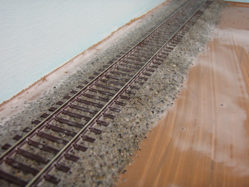

And here are some images of the ballast before and after wetting/glueing:

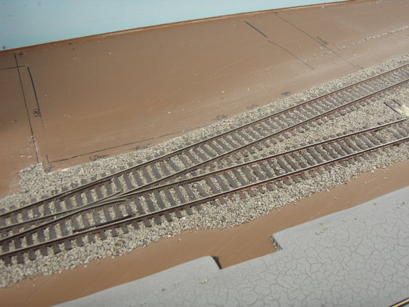

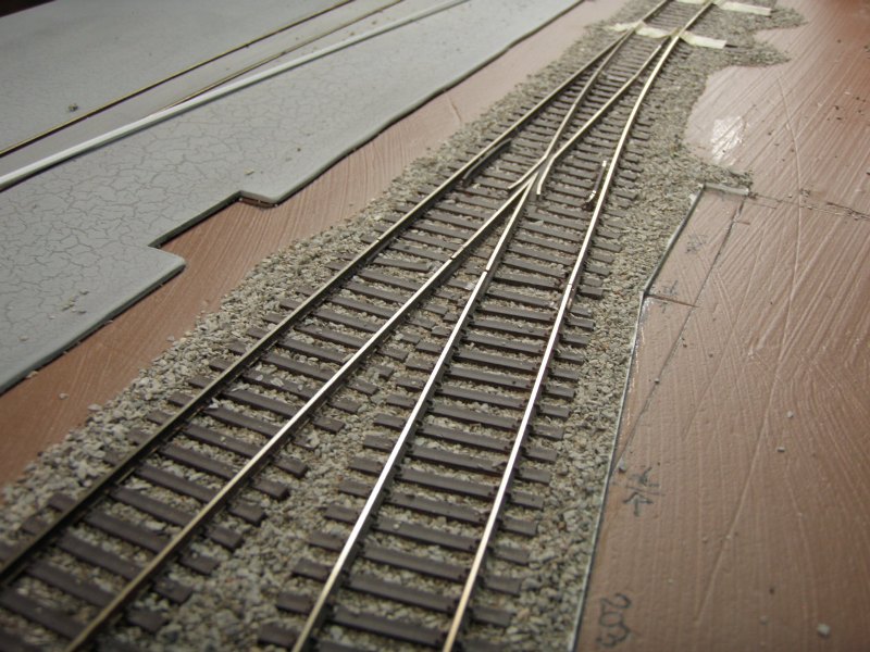

Work is going really pear shaped so have had little or no time to do any real work on the layout... I have a few pics of the areas I have managed to ballast and ground cover... Sill a looooooong way to go but I am happy with the colours and textures I have achieved...
Some Ballast preparation:

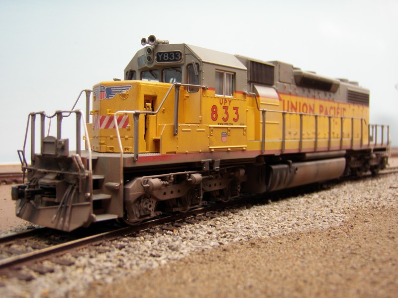

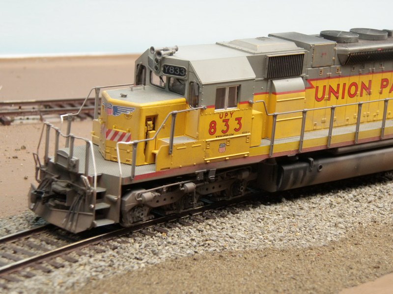

Here are some shots of UPY 833 moving through the dry area of SSWUPinSA:
That looks good Thumbsup I like the way you do the ballast and the area between the tracks.
Thumbsup Thumbsup
Harry
Scale Z and N
Those turnouts are A#1.... Thumbsup
And the locos aren't half-bad either..!! Goldth
Gus (LC&P).
Your ballast looks spot on. Great stuff. Thumbsup

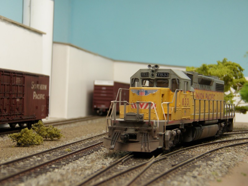

Thought I would post at least something for you guys to look at... Work (real work) has not permitted much work on the layout... Replaced some of the mockups and took a few pics:
Hope you enjoy!!!
That looks good! The gray ground cover in the foreground of the lower photo is very level/flat. How do you do that?
