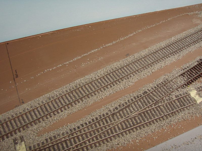

Well I'm getting to the business end of the ballast. Decided I now have the right material and mixes for the mainline and the spurs. I will be ballasting a cleaner more even sized rock for the mainline and staging yard as these would typically be better maintained. I am then mixing in various degrees of soil and darker ballast for the spurs at the industries, most of which will have grass and weeds on them...!!
I finally have a couple of photo's that do show the maerial in abetter light...camera setting do help!
And here are some images of the ballast before and after wetting/glueing:

That looks good Thumbsup I like the way you do the ballast and the area between the tracks.

Your ballast looks spot on. Great stuff. Thumbsup

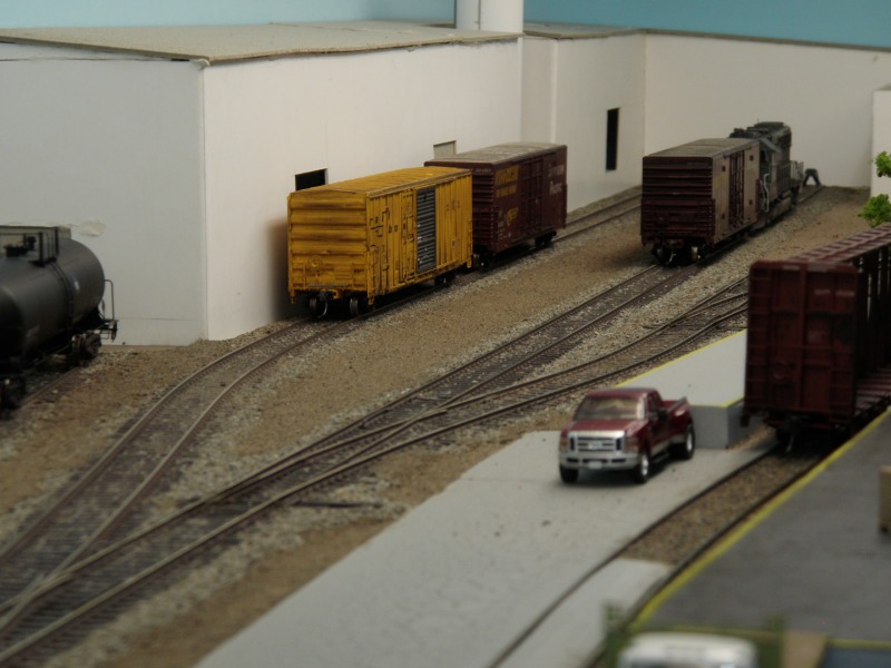

Thought I would post at least something for you guys to look at... Work (real work) has not permitted much work on the layout... Replaced some of the mockups and took a few pics:

That looks good! The gray ground cover in the foreground of the lower photo is very level/flat. How do you do that?
I have severe problems to get it really level. I get the fine ballast/sand etc. level on the ground. I spray it with a fine mist of water/alcohol. When I put the glue/water mix with a pipette each drop makes a little crater. If I move the pipette while the glue is dropping it creates little channels.
I do later on soak it with more water and sprinkle some more ground cover on to cover the craters and channels but it is far from perfection.
Reinhard....What I do is brush white glue on the "ground", then spread the gravel/dirt over it with a sifter. Once I got the "look" I want, I spray "wet" water over it to allow the gravel/dirt to soak up the glue underneath. After several hours, I'll go over the area with a spray of very diluted white glue. The ballast will go over the ground...just like in the "real" world. Works like a charm.... Goldth
Gus (LC&P).
Gus, thanks for the guideline. i will use it the next days.
One last question: The white glue you put first on the ground, is it deluded or 100% glue to be soaked up?
Reinhard...It's 100%...Straight out of the bottle....
