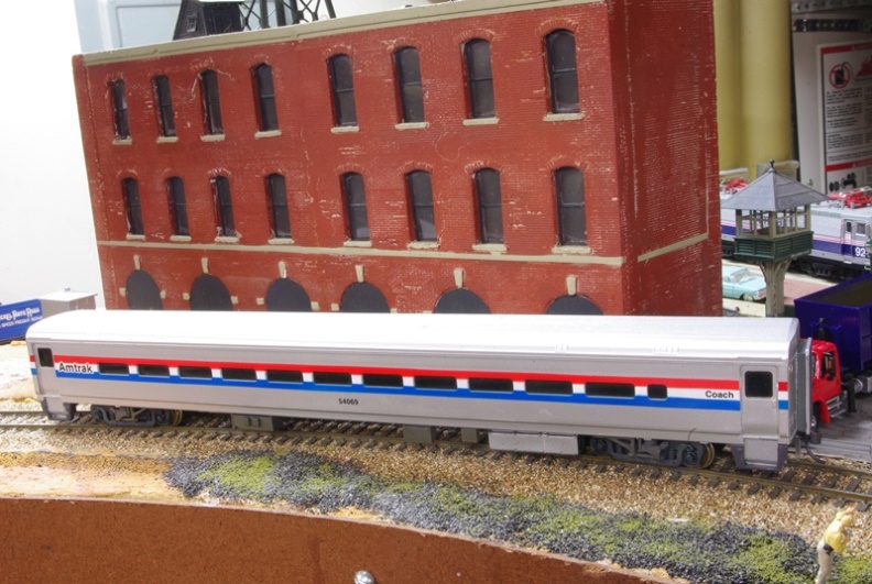

Here's a Walthers Horizon car that I recently pulled out to bring up to consistent standards with the others I have. As shown here, it's pretty much stock except for a coat of grimy black and a little weathering on the underframe. It even still has the horn-hook couplers that Walthers stopped including in the 1990s sometime, if not earlier.
Horizons get a lot of use on Midwest services, and there are also some remaining in California on Surfliner and San Joaquin trains. I'll show what I'm doing to Walthers Horizons to bring them up to a better standard, inspired by the late Frank Cicero's articles in RMC. A shame we lost the guy, nobody's doing anything like that any more.

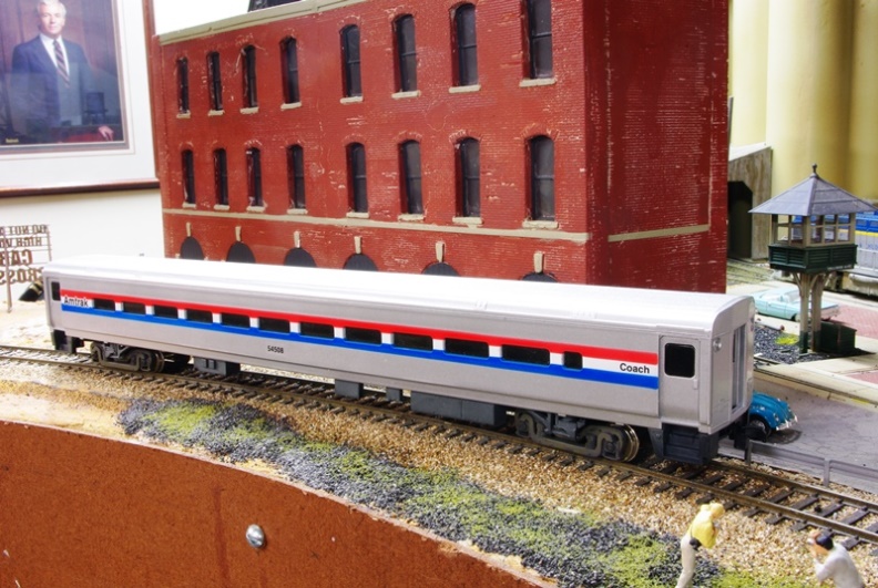

Here's a Horizon with the improvements I've made to date:
These include underframe/trucks weathered and painted, long shank Kadees, the battery box painted platinum mist, 3-stripe continued onto corner post with Micro Scale decals, diaphragms (IHP used to make cast metal versions, but Train Station Products makes the same thing in plastic), and markers on ends colored with metallic red enamel. The cars in Phase III stripes had step covers that were in place when the doors were closed, which haven't been added here yet. I have some on order. Phase IV paint scheme, however, involved Amtrak installing new doors with smaller windows and doing away with the step covers. I'm not sure if Walthers ever did these cars in Phase IV paint, but you'd have to change the doors to make them correct.

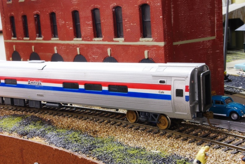

Here's an equivalent Walthers Amfleet with similar changes:
Underframe painted and weathered, wheels painted rail brown or dark gray, 3-stripes continued onto corner posts, diaphrams, HEP cable covers on ends painted white and blue, markers touched up with metallic red enamel. I don't know if the new version Amfleets are going to be so much of an improvement that I'll get any; I still have some old, old Soho brass Amfleets that could quite possibly do just as well. But in 1996 I was traveling and found a hobby shop that was selling a huge stash of Walthers 1980s Amfleets at a very good price, so I have what is almost certainly a lifetime supply of these.

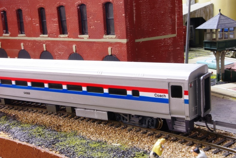

A Walthers Horizon with Train Station Products step well covers added:

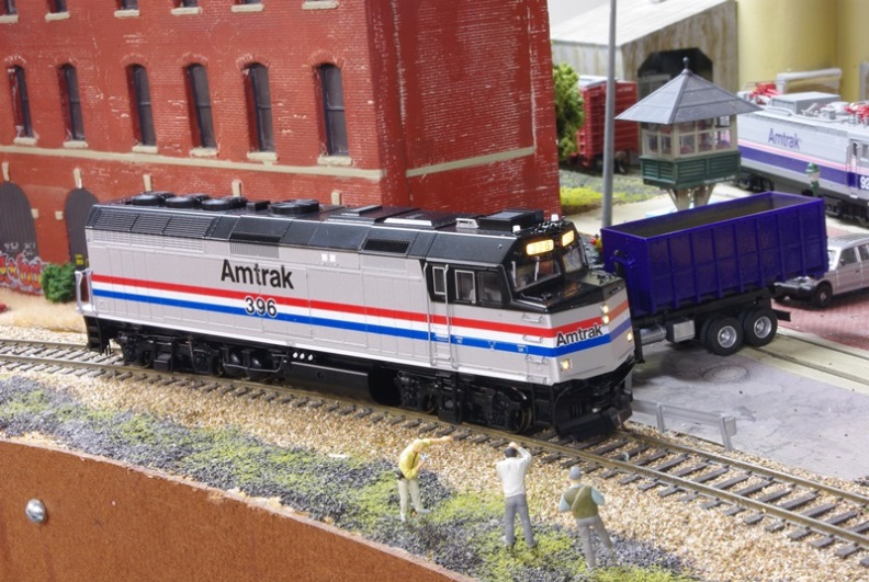

And a new Kato F40 factory-equipped with DCC and sound:

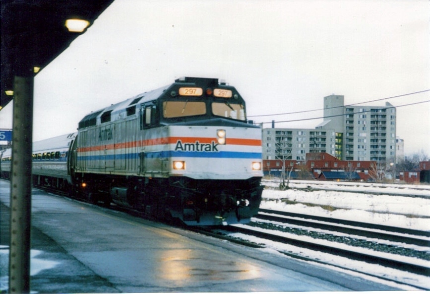

I have many, many photos of F40s over the 20-plus year span of their lives. The ones with ditch lights are very, very late, and I'm not sure if all of them got ditch lights -- I have shots from 1995 without, but here's one from 1997:
I really like the sound on this one. Real F40s are loud, since the engine is always in run 8 for the HEP. This one's loud, too, but it also has the random compressor noise, air bleed, and so forth, so that even stopped, it's always doing something. Alive, like the real thing! Some guys like sound. I've been getting my feet wet very slowly, but I'm definitely deciding I like it. Haven't run the thing full volume for my wife yet, though.
