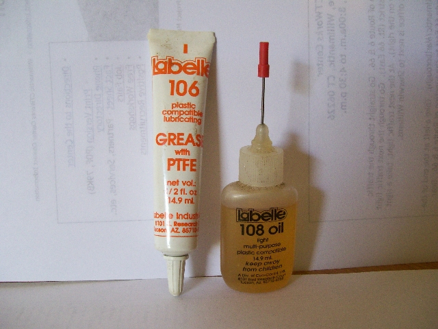

These are what I use to lube my locos with. For less than $20, you could probably do them yourself. As you can see, I've had these quite a long time. I've even used them on a tag sale slot cars to get them running, for the grandkids.
Once a year I'll take one or two of my locos apart and clean and lube them. Maybe a shorter time for my favorites and I run all the time.
I usually place a drop of the 108 on the motor bushings, and bushings on the ends of the cranks of my steamers.(easy..as I only have two), and a small blob of the 106 on the gears.
