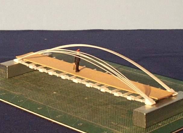

The "iron rods" that make up the arches, and the "bowstring", are Evergreen #218 .020" rod. The "plates" that bind the rods together, and provide attachment points for the vertical struts, and diagonal bracing were fashioned from Evergreen #4526, "metal siding" .040" spaced, .040" thick ( the .020" rod sits perfectly in the precut grooves of the siding ). The deck support "I" beams are Evergreen # 271, I-beam, .060". the deck in the photo is a piece of Northeast scale scribed basswood sheet. I'll more than likely use scale 2" X 6" lumber for the finish decks.
I'm building three spans 50' each, as a walkway out to the bridgetender's shack. They will span an open water area already limited to 8' above mean high water clearance, so they will be set at the same height. these will be part of the "new modules" project, as is the boathouse build. in the "Summer Challenge".
I'm holding off on the other two........as I'm building this one, I'm learning the "better ways" of doing this project. I'll correct the mistakes, and do it right on the second and third spans.

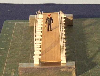

Sense of Scale.......There are some things that really need to be shown with "known objects" to convey that sense. The figure on the bridge deck shows the comparative size of the bridge, the "inches" on the cutting mat, show the actual size. I don't remember "learning "that, it just made good sense.

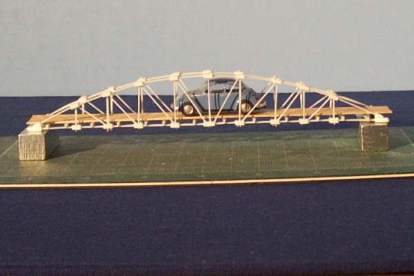

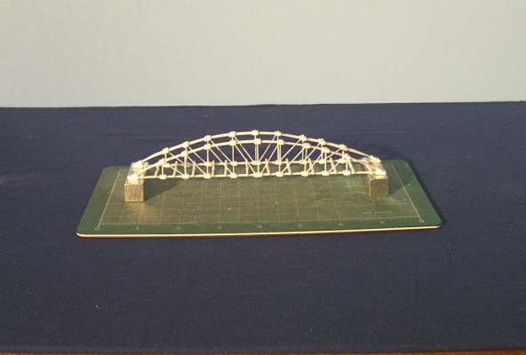

I got the .020" styrene rod, and finished the verticals. the diagonals, .025" rod, were then added, and the ends clipped to the proper length. In the first shot, the completed bridge frame. I set a 3 ounce steel bar, in the center of the span, and the vertical deflection was 3 scale inches, at the center. That's a strong little bridge, for a walkway !
This second shot is at approximately eye level, and yes that is a VW Beetle parked on the timber deck. Driving on to the bridge was easy, backing off ?.........Let's just state for the record that the bridge and the VW survived the experience.

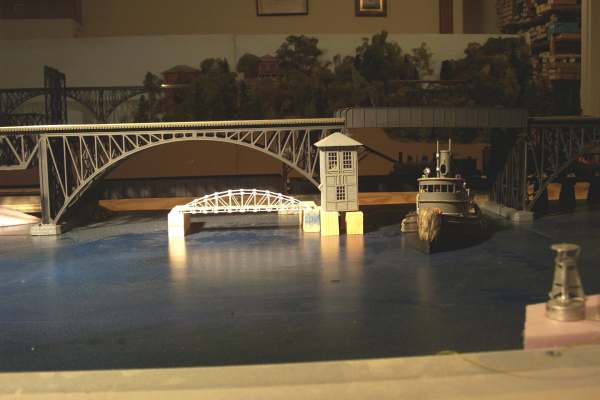

This third shot is approximately where the finished bridges will go.
