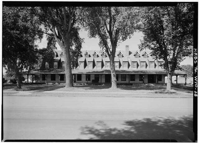

#20
if you are planning to make it full scale size it is going to be a large building, attached is the only think i could find that looks close to the size of the wonderland that i have drawings of the advice of compressing it might apply, though it is different i think the size is close to the same its 119ft 6 inches, in real inches its over 15&1/2 inches , the other thing is it was in a national park and the park service had it torn down you might contact the park service or the company that tore it down to see if there are any drawings or measurments .
i will also second Doc's advise on using plastic i have built a bunch of wood structures and after a few years things start to break down and the wood can shrink or swell causing additional trips to the work bench, if you have trouble with the slovent vapores you might think of building in a airbrush booth , there venting the fumes awav from you.
I'll also second CNW's advise on using tichy windows and doors they are cheeper free shipping on orders of over 25$ and a discount on orders over 50$ and also are of a different styreen that is easer to modify them.
you can also order derect from evergreen no frills but they sell 12 by 24 inch sheets which would mean less splicing.
jim
#21
More snow and ice today here in DFW, ice is pretty thick on the roads, so I'll close the dive shop and stay home to work on stuctures. :mrgreen: Might even start trying my hand at sketching preliminary drawings of Wonderland.
More good advice and thoughts....biggest reason I am leaning toward working with wood is because I enjoy it more so than styrene. Also I thought it would obviously look more "woody" once stained and painted. Although I have seen a lot of styrene work here on BB that looks "woody"...Wayne and Gary have proven that. Worship Even wearing a mask, I seem to have allergic like reactions to most CA and even the old-school Testors model glue we used as kids. Nope Heavy sanding of the styrene gets to me as well. I didn't know that wood and glue have long-term problems...hmmmmm....
