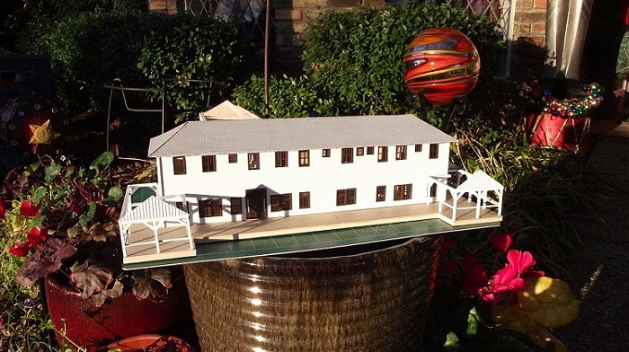

Thought I would resurrect this thread to update the progress on the Wonderland Hotel. Hard to believe it's been almost 2 years since I started this thing....The majority of that time was spent on research, a fun but time consuming part of the process. After exhausting multiple resources, it was becoming apparent there just wasn't much in the way of pictures of this century old complex. It had gone through so many restorations and additions, it was difficult to actually see any usable pictures. The ones Allan gave me were a compilation of several buildings, not just the main hotel. Allan didn't tell me that, and there was little evidence to suggest otherwise.....
THEN a miracle happened.....I stumbled across some drawings from the Library of Congress and was finally able to figure out the layout of the hotel complex. My original guesstimations were only 3' short! So, here is where I am at this moment....the main building is made from wood, using strip wood from Hobby Lobby and stock wood from Northeastern Scale Models (?) and doors and windows from Grandt Line and the junk box. The hotel is framed and painted and now I'm working on the roof/shingles and the porch and gazebos on either end....
Only a couple of weeks till the train show, so back to work I go.....

Looks good so far, keep us updated.

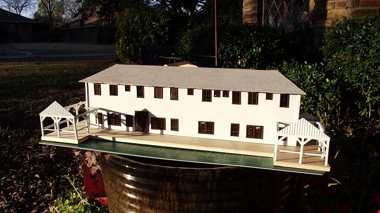

A little progress update.....got the roof rough-cut and ready to trim/fit. Porch gazebos are ready for roof....next up will be working on the porch between the gazebos....Nothing is permanently down yet, so thing look a little loosey/goosey...

Thumbsup looks great Thumbsup

Very nice job.

Thanks for the comments...yeah it's hard to believe I have been putzing with this for 2 years already. It would be a good Duff project Sumpter, but I'm afraid I won't get it done in time....after all the research, this project has turned into 3 complete separate buildings, this is just the first one....more pics over the weekend....
