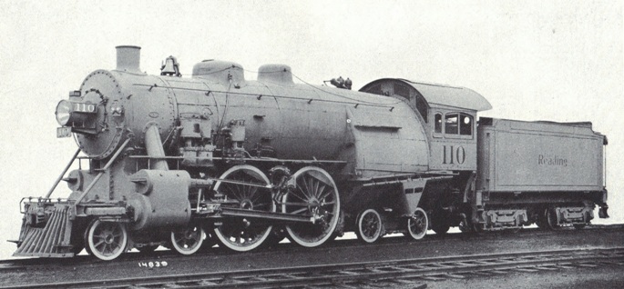

Mantua back in the 50's made a Reading Class P7sa. There were 4 of them. The only non-camelback Atlantics they owned. They were built from the Reading type C1 class 4-4-4. These were made by the Reading in their shop between 1913 and 1915. Now i am backdating my P7sa to a C1. Let's see how it comes out.
Please no laughing. If you have to - - - Ok do it.
frank
Here is what it will look exactly like when done. cough, cough, cough, gough ! - - - Just clearing my throat.

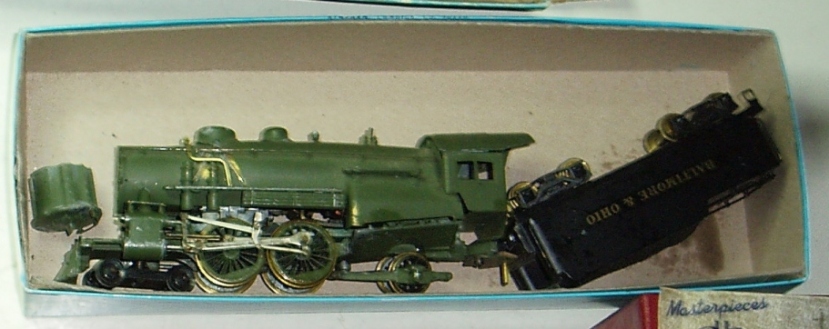

Here is how it looks at the start.

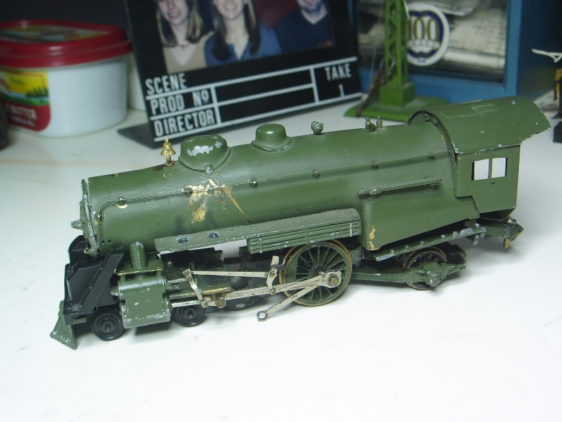

Here is what it looked like when I got it,
frank
I was playing around with some ideas.

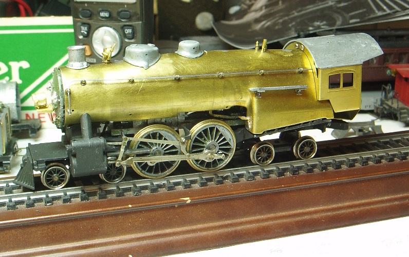

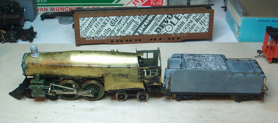

Here is where it is today. still playing around.
Spoked trucks for Rivarossi 4-6-0.
New front pilot Selley
New smoke stack selley
With original tender
A little more work, with Mantua tender.
" It's a Heck of a Day " !!!!

, Your off to a good start. I'll suggest that you may want to try using the rivet decals available from Mirco-Mark <!-- m --><a class="postlink" href="http://www.micromark.com/HO-scale-decals-with-raised-3D-rivets-and-other-surface-details,9968.html">http://www.micromark.com/HO-scale-decal ... ,9968.html</a><!-- m --> as to emboss rivets on a factory model would be extremely difficult. I do want to see how you add the boiler bands and other details to the model also. That triangular ash pan is a distinctive detail on the prototype, How are you going to handle that too? Good luck with it..

* Steve ; I noticed that detail on both Reading and D&H locomotives. I think it alows the ashes to dunp away from center of the track . Only problum I see is getting the thing to stick to the painted and cast metal ashpan of the mantua loco.

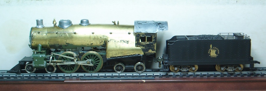

A little update ;
* A photo update.
a few more photos. each side.
frank
