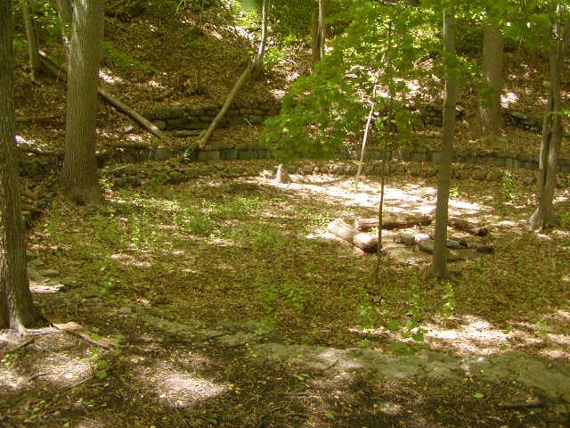

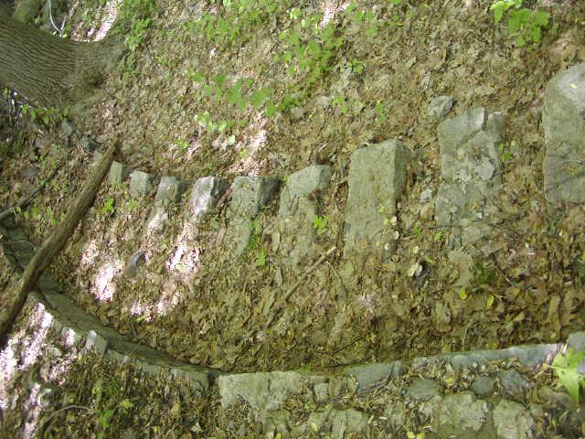

Thanks 88. A few pages back you mentioned how with the removal of a few locos the roundhouse scene looked abandoned. Today I went for a walk, a half mile or so from my house is abandoned trackage for what once was a iron foundry where nails were made. There was a small turntable and all that remains is the pit, here are some pics from this morning.

That turntable must have been removed some time ago, because those trees in the pit are kind of big.

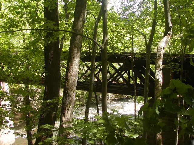

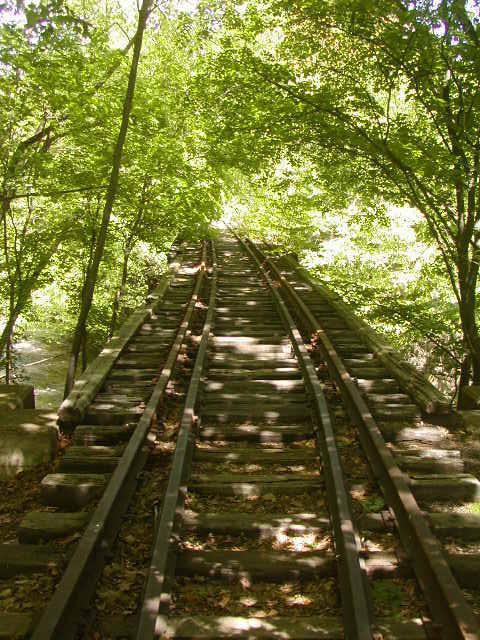

Yeah, it's been awhile! I can't remember what I read about when the foundry closed up. It was built in the late 1880's if I recall correctly. 10 years ago or so there were remnants of small ovens built into a hillside on the other side of the river and historical markers with data about the area. Vandals destroyed the markers and time has destroyed my memory! The foundry and the Morris canal were the reason for Boonton's existance back then. Here are two pics of the bridge over the river to the foundry, also taken this morning. Hey, if our get together in June goes well, perhaps we can get together again sometime and I'll walk anyone interested around the area, and maybe run some trains.

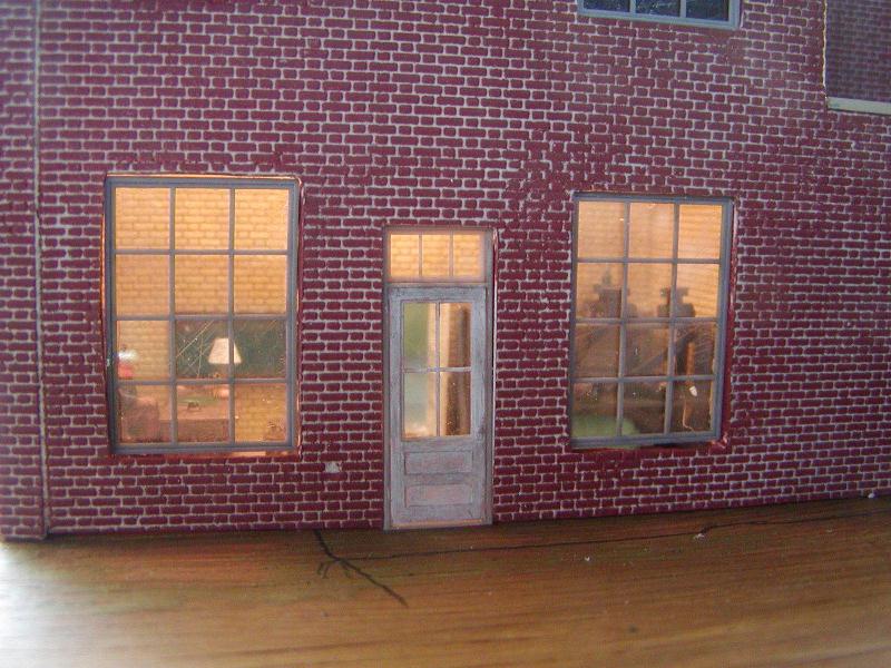

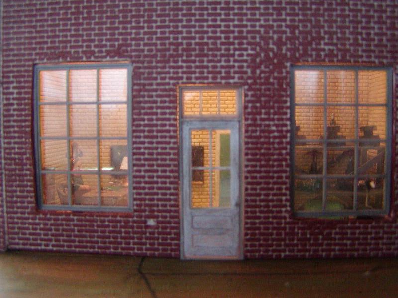

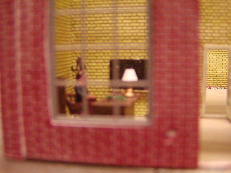

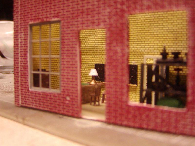

I've built and painted some interior details for the powerhouse office. The first two pics were taken on my workbench before the roof was in place. So it is lit pretty well. Unfortunately, once I added glas to the windows and inserted them in the wall and added the roof in place on the layout, you could no longer see much inside. So I had to add lighting, and the second 2 pics show the result. I have some work to do to seal the light leaks around the windows. And I still need to add window sills and other details. But I'm pretty happy with things so far. I find it difficult to get eacat precision openings in masonry walls for the windows. Wood buildings are easier since the window castings mount from the outside. Oh well, if I insisted on perfection, I would have to leave the hobby!
Last photo will be on next post, I guess I reached the limit.

One more photo:

Looking good Gary!!!!
I hate making custom window openings in brick walls, especially the thicker ones like Walthers and DPM, but sometimes you have to. My technique is, instead of trying to do a flush mount as it looks like you've done, I mount the window on the inside. If needed, I will add a little more to the outside frame of the window, especially if I am cutting one down. Obviously this requires a little extra work on the inside of the window if the interior side is visible, but it really works well in compensating for the inevitable "oops's" in the window openings.

Lookin' good, Gary.
Another suggestion for hiding the gaps is to install window sills (as you mentioned) and stone lintels over the tops of the windows. To seal gaps along the sides, use Evergreen quarter-round or strips, in an appropriate size, applied over the gaps, on the outside of the structure - the prototype often used trim called brick moulding just for this purpose.

Thanks Val, Wayne. Quarter round strips huh? I'll check that out. Val, I don't quite understand what you mean, would it be possible for you to post a photo?

Thanks Val, I get it now. The Tichy windows I use are .040 thick, so I could edge glue .040 styrene strip to them to accomplish what you describe. Now that I'm thinking about it, the way I prepared the windows was to glue clear styrene "glass" to the back of the window casting, cutting it a bit larger all around to make a flange to then apply glue to and insert the window from inside. If I had painted the clear styrene black in this flange area, it would have blocked the light. I am going to see if I can remove the windows and try this. It really wasn't so noticable until I installed the light.
I had pondered the possibility of using something like appropriately colored spackle in one of those syringe applicators to apply filler. This would be a last resort type fix, what are others thoughts on this?

Personally I would use putty to fill the cracks cuz i'm lazy!!
