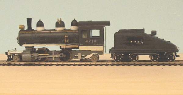

Hi,
I recently came upon a rare picture of a locomotive specifically built by MLW to work on wharves at Quebec City. At least, two of them were 0-6-0 with slope tender. It was built in the 1910s.
[Image: QHC-3.jpg]
Among all models easily found on the market, all USRA-based models are a no-go. I found that the old Roundhouse 0-6-0 switcher was very, very, very similar in both look, proportion and details. It would be a great candidate for bashing and redetailling. Also, I like the all metal construction that make it a good puller.
I would like to know if making it DCC would be relatively easy and if sound could be incorporated in it... (the tender is so tiny!) Can it be upgraded to modern standard and still be a good engine at slow speed? Would you suggest a remotoring? I'm aware I should put a lot of work on it, but if it can save me a lot of troubles.
I suspect this project could easily turn into a frankeinstein thing! If you know of other suitable plastic engines, let me know.
@Lutz: I've seen in some topic here your reworked this engine. Were you satisfied with the results?
Thanks!

Hello Matt!
[Image: dsc05348firfe.jpg]
[Image: dsc0535398qbb.jpg]
[Image: dsc03734z70l.jpg]
Do you mean this engine? This is the later version with plastic body.
[Image: dsc0216617o7.jpg]
I own an really very old all diecast model too. The gear ratio of the diecast is 1:35 and for the plastic is 1:70. As delivered both have open frame Pittmann motors.
The prototype was, i am not a SP crack, a Southern Pacific switcher built by ALCO. It must be an older series with inner Stephenson valve gear and slide valves.
The plastic shelled model was those which i rebuilt to modern standards.
In short terms technically:
- remove open frame motor, it is a decoder killer
- replace it with an coreless coil motor (Faulhaber, Maxon, Escap, etc.)
- make a new motor cradle, the motor could be mounted horizontal and can simple glued onto cradle and frame
- make shure the gear mesh will be correct. The trick with a piece of thin paper stripe between worm and wormgear will work well here.
- if the loco will be run with DCC only, a flywheel is not really necessary
- NO CHANCE to current pick up problems!
- for this polarity of loco and tender should be the same
- make wipers for loco wheels, i did it for first and second axle wheels
- make wipers for all tender wheels, don't let spoil your switching fun by problems with bad pick up
- for lighting purposes i mounted 3mm warm-whithe LEDs and the necessary resitors for each LED
- loco and tender are permanently coupled
- at least 6 wires are connecting loco and tender: 2 for current pick up, 2 for motor, 2 for LED
- build a NMRA 8-pin socket into the tender so so can choose the decoder you want and replace in an easy manner
- insulated Kadee coupler boxes
How i have done that:

[Image: dsc04962l1upu.jpg]
Inside of the tender. My Roundhouse 0-6-0 has no sound, so this brass tender of similar seize is an example.
A Tsunami 750 Small Steam decoder, a 3/4" speaker and the corresponding baffle kit. At the right side in this photo is the NMRA 8-pin socket and plug. I wrapped it with tape because an all brass environment is prone for short circuits Wink
Left there is in this case a mini socket with 12 poles. Only 7 are used for connection to the loco.This may not be necessary if loco and tender are permanently coupled.
Here was enough space to make a small baffle with low profile and mount the decoder atop.
For optical look.
A lot you can see on the photos.
As the coreless coil motor is much smaller as the open frame pendant, it was possible the make an cab interior:
- the part of the boiler reaching into the cab
- boiler backhead
- cab floor
- fire box sides to hide motor and close the gap between firebox and frame
- bridge between loco and tender
All was simply made out of styrene sheet. Even the open cab doors were made out of it.
This was my first attempt to rebuilt an US loco. Simply because there are no plstic or die cast models of those older switchers on the market.
Big steamers, no problem, nearly every well known model was realized in plastic.
But small switchers? No Sir, only the Roundhouse or you have to go into the brass market.
So it was my choose to rebuilt this really antique Roundhouse model.

6. You've got it: a top-feed check valve. Thumbsup The water line on the fireman's side also connects to this same valve.
7. That's an air-activated bell, and is, as you note, fixed in place. The clapper is moved by air pressure which is activated from the cab and regulated by a self-closing/opening mechanism. The Precision Scale catalogue shows two dozen bells, several of them air operated, although none are exactly like that one. The easiest way to simulate it is to use a standard non-swinging bell (one-piece casting) and add an airline to the bell bracket.
8. Not sure about this one. It could simply be an exhaust steam line from appliance, or may have something to do with valve lubrication.
9. You're correct on this one, too, Matt.
On the fireman's side of the loco, that pipe entering the smokebox is indeed an exhaust steam line, but I have no idea of what that fitting is called. Misngth
That does look to be the air pipe running to the pilot deck, but the usual practice was to run the piping to the opposite side of the loco, through cooling coils, then back to the cooling coils on the fireman's side of the loco, then to the air tanks. To sufficiently cool the compressed air (in order to avoid false pressure readings), a minimum of 75' of pipe was required between the compressor and the air reservoir.
As for those air compressors, the single phase pumps generally weren't fitted with air strainers like those used on the cross-compound type. The inlet for the air is visible on lower section of the rear pump - it's located right near the top of the lower section, facing forward - a stub of a pipe with an open end (the end would be covered by a metal mesh to keep the bigger lumps out of the system). Misngth
I didn't notice until I had gone through your questions, but the loco shown is out-of-service, with its main rods atop the running boards (the bearing end is within the yellow circle on the fireman's-side view). Also note the cover over the stack to keep the birds out. Wink
Matt!
Have you ever thought to this:
<!-- m --><a class="postlink" href="http://shop.cad-im-modellbau.de/product_info.php?products_id=3744&XTCsid=ejqfmm1o11ns4gnlrbo9lu22b3">http://shop.cad-im-modellbau.de/product ... rbo9lu22b3</a><!-- m -->
<!-- m --><a class="postlink" href="http://shop.cad-im-modellbau.de/product_info.php?products_id=3748">http://shop.cad-im-modellbau.de/product ... ts_id=3748</a><!-- m -->
It is only an example what i mean.
There also must be in the US or Canada dealers for model ship builders stuff.
Get the ones made out of turned brass. Not the lenght is important, but the seize of the turned knobs.
Cut them in pieces just above the knobs, so you get, depending on type, 2 till 3 loco handrail stanchions out of this nautical handrail stancions.
At least they are not so expensive as lost wax parts.
Years ago i begun making my handrail stancions for locos out of those ship parts.
Pete has explained all of your questions.
My remarks:
8) i believe this are oiling pipes from the central oiling device to the cylinders
The tube into the smokebox: This may be an auxilary blower. Here steam can be blown onto the blastpipe while the loco is standing to get more draft to the fire.
Lutz
Lutz!
Schraddel Wrote:Years ago i begun making my handrail stancions for locos out of those ship parts.
Clever idea! And at least my LHS carry a lot of ship parts. What I like, is tht you can easily adjust the lenght to your need. Particularly useful for tender stanchions.
Wayne!
Great info as always. You're a livig encyclopedia! Maybe I should get a book about steam locomotives. The more I learn about how they work, the more I'm getting interested in them.
doctorwayne Wrote:Precision Scale has handrail stanchions in various styles and sizes - I counted eleven different ones in my catalogue. I believe that they have a minimum order of $20.00, though. While you're very adept at making detail parts from found items, Matt, it may be worth your while to order their "HO and HOn3 Steam Locomotive Super-Detailing Parts" catalogue. That, along with a few packages of handrail stanchions, will easily put you over the minimum. Wink
I'll follow your advice. Thumbsup But I'm puzzled by their website. Except a few items and catalogs that can be ordered with their shopping cart, there's no clue how to order other parts...
