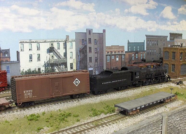

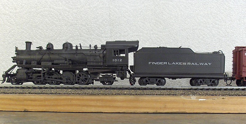

another with some weathering.... my camera and photography skills dont seem to do it justice.... should take a shot on the layout
A few bits missing in this pic like the railings on the boiler, grabs on the back of the cab and deck plate between cab and tender... but you get the idea
#32
Looks good, Thumbsup Thumbsup especially with that NYC-style lettering. Looks like she's got one of those Proto1000 Fowler Patent cars right behind the tender, too. I just picked-up another five last week - I wish they were cheaper, though. Eek Misngth
#33
Good eye Doc! Yes that is a proto car.... they can be a bit pricey but I give myself a really good deal on them as I own the hobby shop Big Grin
I may need to get Squidbait to take some shots of 1012 on the layout with his fancy camera as the details of the weathering just dont seem to show well in the pics but seem to show nicely in person. Probably lighting and exposure issues... but I have too many other hobbies now so photography isnt going to turn into another.

Hey DW: would value your opinion (and others) on a thought I was having. I was considering adding wooden side boards to the top of the tender to allow for more coal ... but more importantly for visual impact as I think it would make a neat detail. What do you think?
also have been mulling over painting the cab window but not sure what color... dont really want to do red as that doesnt strike me as NYCish.... all the NYC images I have seen are B&W but it would appear the window mullions are black. Maybe just a slightly lighter shade of steam power black to hightlight it slightly?

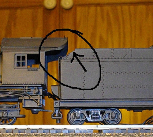

Missed detail first: somewhere somehow the front corner of the raised coal bunker on the tender has been broken off. I have looked at my pictures to date and it seems to have happened fairly early on and although its tough to see in the images... I now know its there... sooooo I ordered a new tender. I can't believe I missed this out of all the pics I took and the time spent working on and lettering the tender.... Ah well... next one will look even better right??
Blunder was one many of us have made but it still hurts.... was working with CA and managed to get a wee bit on my thumb... just enough to leave a mark on the side of the tener when I picked it up DOH Wallbang 35 ... oh well this was after I realized the edge was broken
At least the sound install wont have to be re-done. Just have to paint, letter and weather the top of the new tender when it arrives....
Aint life just grand.
#44
Wow! Eek A whole new tender because of that little missing piece - a little bit of styrene would've fixed that little corner, and you'd probably not have been able to see the repair after it was painted.
If you get a ca "fingerprint" on a model, let it harden, then use an X-Acto #17 chisel blade to remove the residue - because it's not a solvent, the ca merely hardens on the surface, and will come off fairly easily.

I havent decided exactly what i am going to do with the current tender.... I know I can repair it but I will also know its been repaired and I can get a replacement at cost (pays to own a hobby shop but not often Icon_lol ) anyway took some shots on the store layout.... not sure I like the side rails on the tender at least not in their current configuration.... probably should have put the boards inside instead of on the outside but I though I might put some nut, bolt, washer castings on there too.... still not sure though. Noticed the cab was slightly askew as well so will have to look into that... still overall rather pleased with the semi-final results
