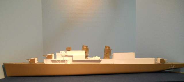

This shot is the full length of the model. Everything that is "dark gray" is part of the "Blue Devil Destroyer" "kit"
Everything white, is scratchbuilt in styrene sheet/rod/strip.

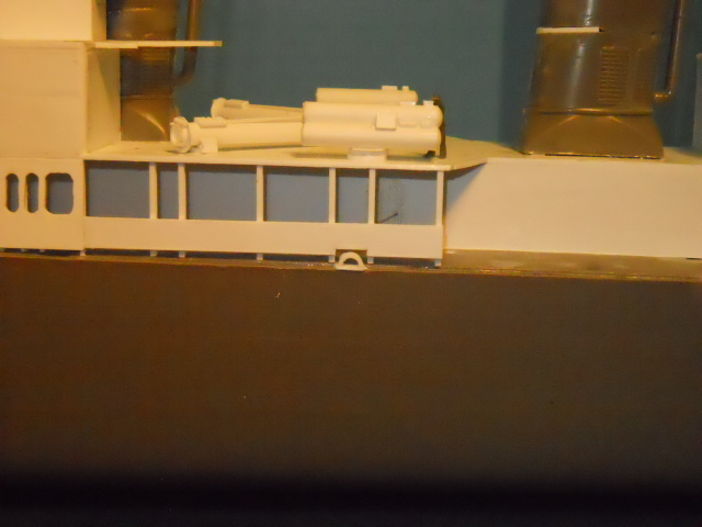

Port side midships, one of the new chocks on the main deck, just to the right you can just make out the handle of one of the quick acting watertight doors, and a side view of the torpedo tubes on the 01 level.
