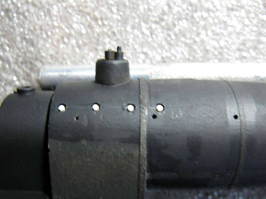

My next challenge was installing inspection and clean out plugs. I had two choices: buy expensive brass parts that don't look like the prototype and are oversized or make them myself. I went with the Red Green's second option as you can guess.
I made the plugs with a combination of holes and 0.040" styrene rod. I first drilled a small pilot hole in the shell of same diameter as the rod.
[Image: IMG_1438b.jpg]
Then, using a 5/64" drill bit, I enlarged the hole surperficially to create a small recess in the boiler jacket.
[Image: IMG_1439b.jpg]
Finally, a piece of styrene rod was glued into the small hole. The rod was extending from the surface and was later cut flush with the boiler using a X-Acto blade.
[Image: IMG_1440b.jpg]
Sure, it lacks the typical rim around the plug, but on many older pictures, it is almost undiscernable. If one would want to make more detailed plugs, I would advise to make the parts independantly, then drill the boiler and insert the plugs. The plugs could be made out of a sprue or a styrene rod with a diameter slightly larger than the largest drilling bit used to shape the plug. Follow my original instruction and you will soon have cheap and easy to install inspection plugs.
[Image: IMG_1444b.jpg]
To be noted, I also drilled the stanchions mounting holes according to the prototype and enlarged the cab windows. There are still a few holes to drill and running boards to mount.
