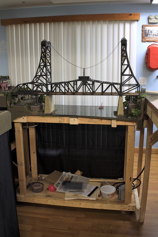

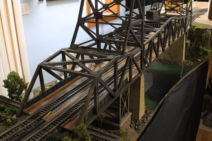

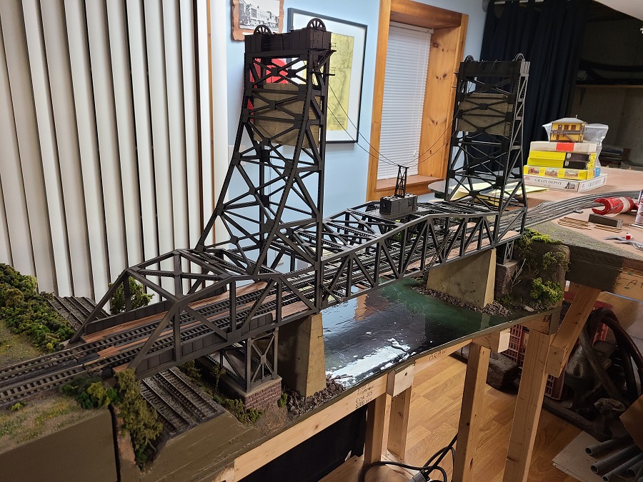

I'll start with some cellphone pics that I had texted to someone. They show an in progress look at the wood deck being installed on my draw bridge.
Here the deck work is just getting started. All the boards were cut from a single sheet of veneer and stained with thinned down wood stain.
This process is now complete and will show as finished in the rest of the thread. I have also installed the skirting and trim around the lower edge of the drawbridge section. That section of bench work is built as a roll-out section to maintain access to the backyard. I intend to leave it installed, only removing it when necessary.

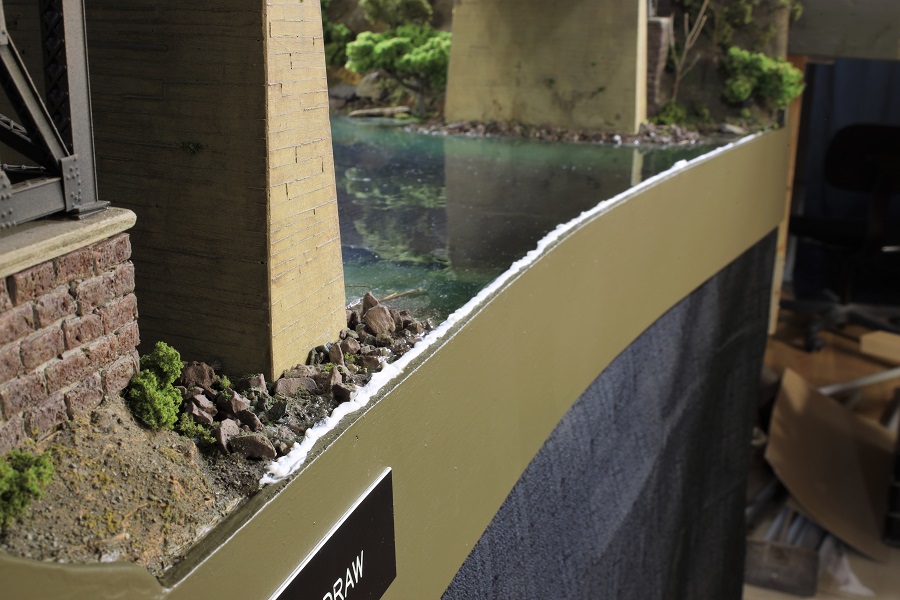

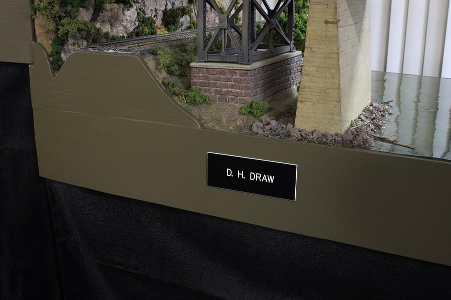

Some trim added around the edge.
Some paint and the name plate installed.

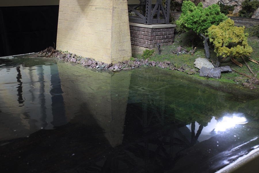

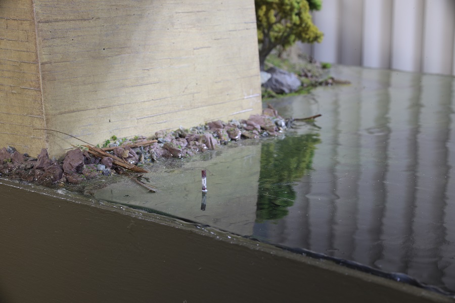

With all that dried it was time to add some Water Effects around where the river meets the trim. This will fill in any gaps and act as a dam for my final pour of fake water. When dry it will end up clear. This was done to both sides of the river.
Posts: 2,724
Threads: 160

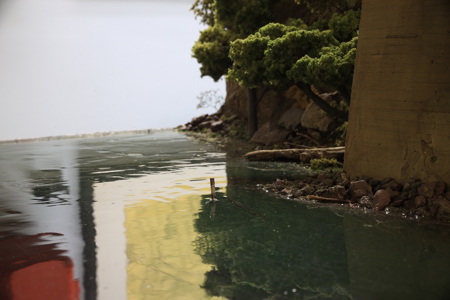

For the river water I have been using Woodland Scenics Realistic Water. It's effect has been something that I am happy with. Just look at that reflection.
I will pour at least one more layer to the river in a few days after the Water Effects is completely cured. The track has also been electrified and fine tuned to running condition. I'll post a video of the first run later.

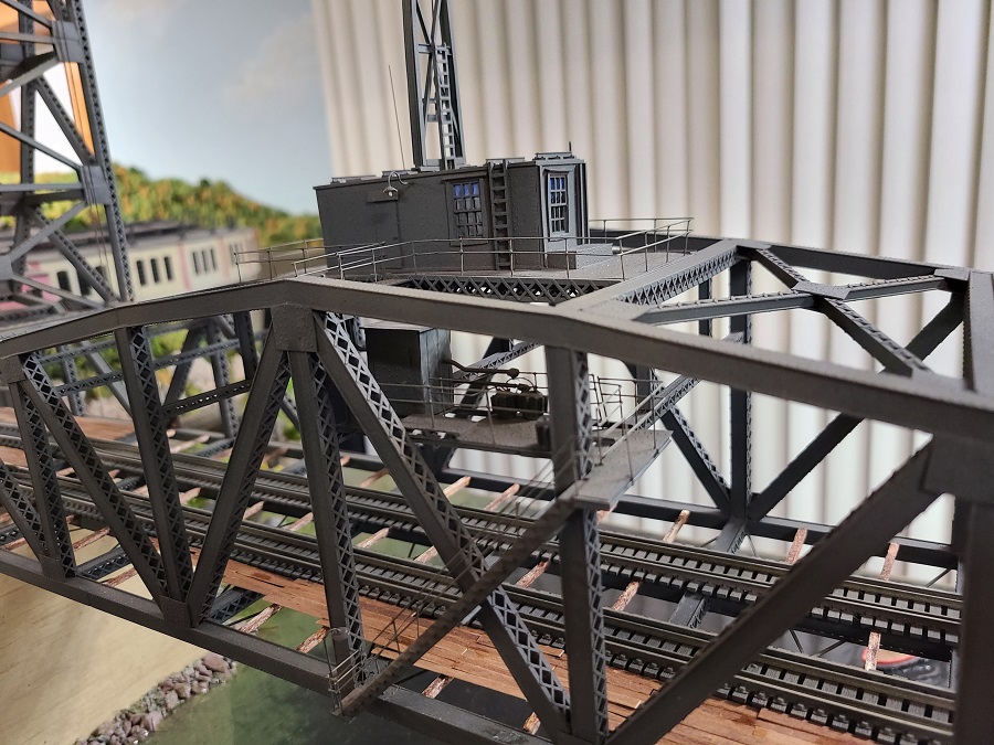

Well here it is my first YouTube vid. Triple-headed heavy Mountains, ( known as softies on the home road for their lack of a wide firebox ) and A CNJ coal drag cross the bridge together to test it's weight limit.
first test run over the new draw bridge. - YouTube

Have you used the Realistic Water before? I used it about 10 years ago. At first it looked good but then after time it shrank leaving gaps along abutments and piers. It also got cloudy.

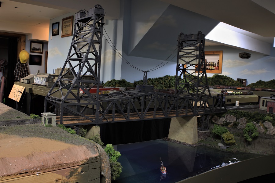

I poured the last layer of water, once it's set I'll add some ripples and things with the water effects.
