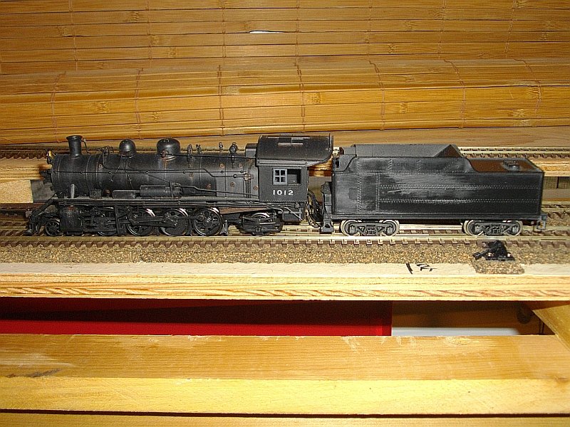

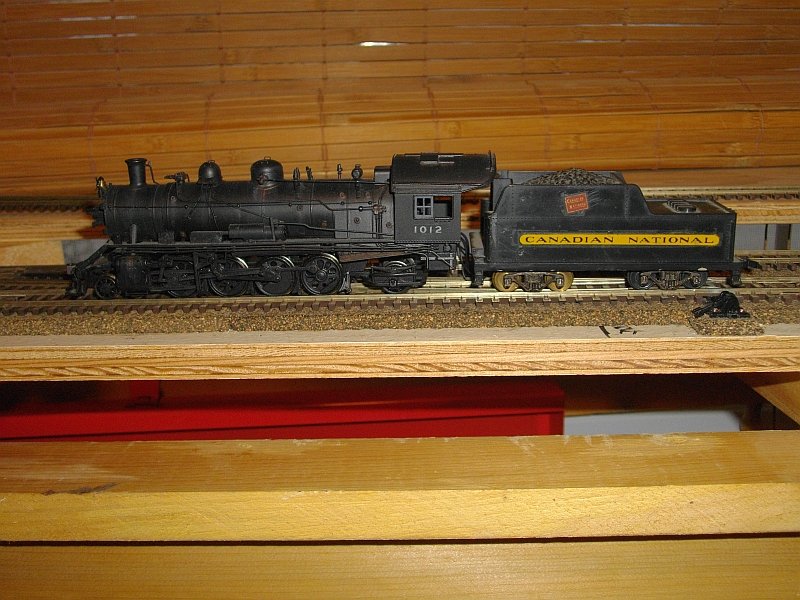

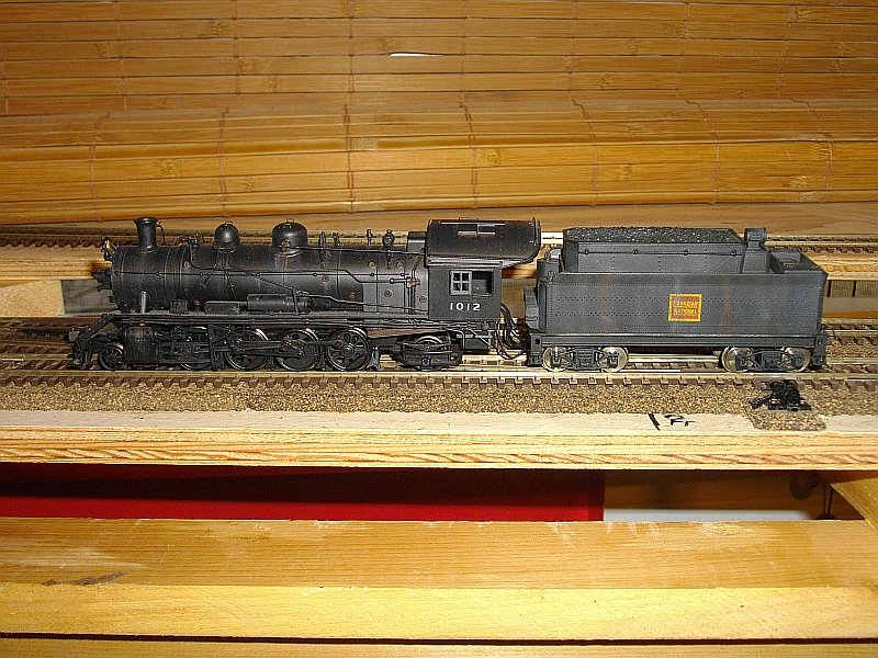

Three tender options I have come up with in my scrounging to fix the broken unit. Each have merit and each will require work (ignore lettering and weathering on the tenders and remember weathering on loco is incomplete)
I like all of them! suggestions from the group?
I still think I like the USRA middle image the best followed by the top one which would need to be lowered somewhat
#62
IHC on top Tyco/Mantua on bottom? LOL. I agree, the USRA works best. Bachmann also used to make a tender for their reading 2-8-0. I am using several of those.

I'll cast a vote for the Tyco/Mantua - the others look too large for the loco, at least to my eye. Wink Of course, you could always shorten the IHC one:

I'm with Wayne... I think the third one looks more proportionate with this light mike... the USRA just looks too long IMHO.
#65
Really the bottom one? I thought it looked too small. The IHC tender sits too high but that is easy to fix. The Tyco/Mantua tender will need some work including a new frame and floor as the existing one is white metal and conductive........ not to metion its going to be tougher to get the sound decoder in there with a good sized speaker. I will say its a cute little tender though......... what to do, what to do

I keep coming back to look at tender #2. That's my vote.

I have no idea what you are talking about.............. Icon_lol or maybe I have no idea what Nachoman is talking about... i assumed he meant the spectrum consolidation and you cant buy those tenders separately and I do not believe you provided one of those in your box-o-tenders I did a quick google and the one image I found looks like a USRA med tender which is the one everyone else seems to think is too big. Anyway I have started in on on the Tyco/mantua version. I did have one of those but the one I had was actually a scale foot taller and longer making it hit the loco cab. The CN one pictured is smaller and fits better.
