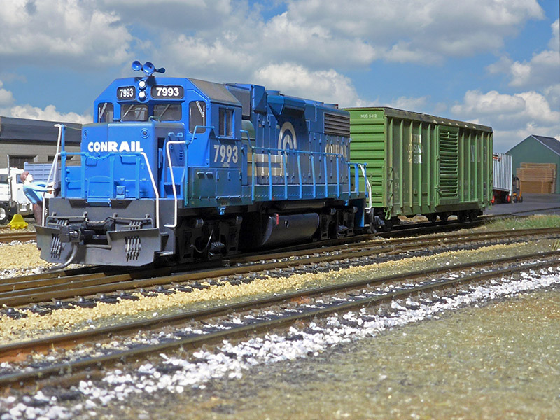

  Weekly Photo Fun 9/14 - 9/20/18
Posted by: bdw9535 - 09-14-2018, 01:33 PM - Forum: Shutterbug area - Replies (3)
Conrail C39-8 6007 heads up a Seaboard Southern stone train as it passes thru Chestnut Neck.
