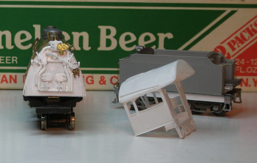

** Next problems encountered. I want to have backhead detail. It doesn't have to be a perfect reproduction on the C1 cab interior. This is mainly because I can't find any photo of what the interior looks like. I can only glean information from the drawings. A problem this causes is backhead won't fit because of me new brass bar is in the way. Well by rebending the bar I can cut off the old cab connection and have uniform curve to brass in this location. Bar has been moved and is no longer in the way. Now I have to craft a backhead with some sort of inside lip connection to the boiler body. Too many words needed to describe the work going into this. It is done now and I have a basic backhead that fits into the boiler rear. Next once the glue is dry and hard is the detailing of the backhead.

Here is the removal backhead on and off.
toptrain
You can see that in the off position I can get to the screw that holds the boiler rear in place.
" It's a Heck of a Day " !!!!

*** Yesterdays drawing of the cab from the rear shows a arm, bar coming at a angle to the engineers. Is this the Throttle ? Also the rectangular thing under, and in the middle of this bar I think is a sight glass. Is this so ? Also does anyone see the brake ?

In this view the cab backhead detail is done.
