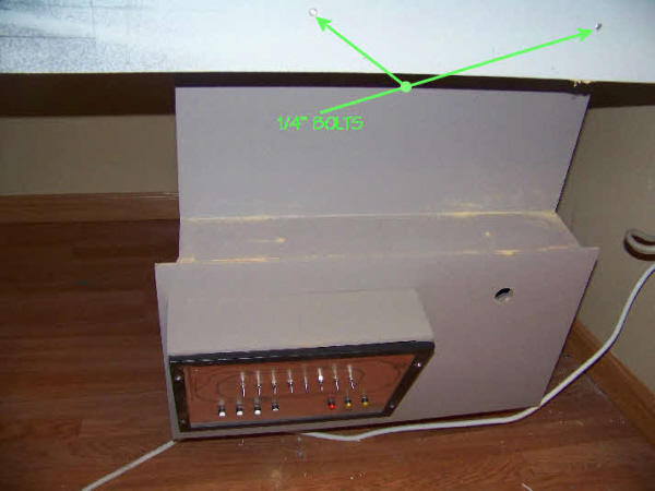

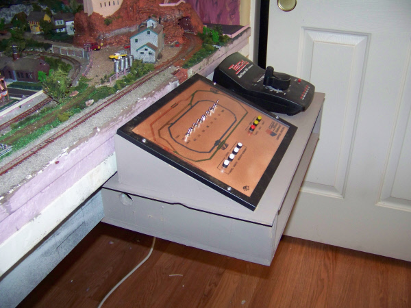

Been over a month since I did anything worth posting. I did finish my swing-away control center and got it mounted yesterday. When in the up position, it's held in place with two bolts into the skirt. In the down position, there is two door hinges holding it. Just one thing missing, no wiring. I've had the control panel built for some time now, just haven't gotten around to wiring it. Also need a way to secure the power pack in the down position.

Velcro will hold the power pack. Nice looking panel Don.
07-04-2020, 06:43 AM
Looks Great Don!
Velcro eh, never thought of that, the pack is light enough for it to work, not a bad option Mike ![]() My thoughts were a U shaped 1x2 setup to put over the top of the pack to hold it in, Mikes Idea is easier

Yup, thanks, got Velcro, can take the feet off and away we goooooo.....
