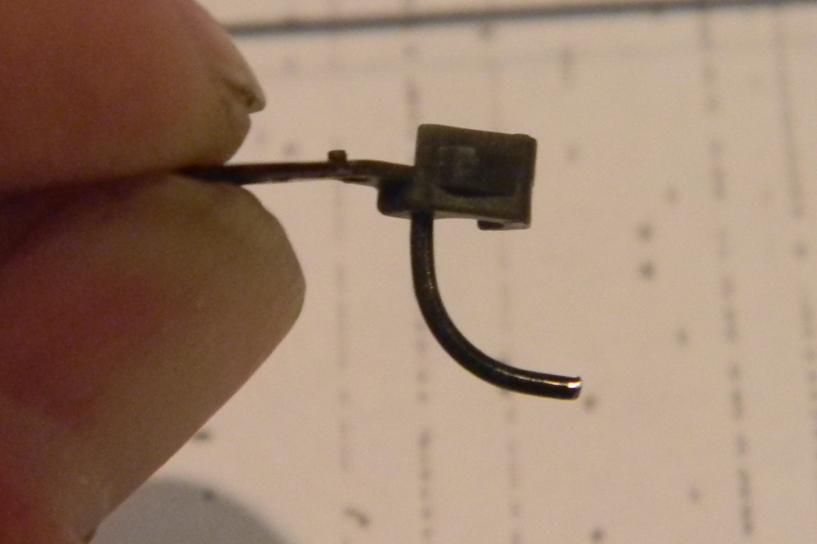

I normally don't try to break this train up - the cars stay together in the same order, so I've been running unloaded and trying to swap cars out to optimize coupler retention and overall operation.  One obvious thing I did find is that two piece plastic Accurail Accumate couplers (found on only one (so far) of these these heavy flatcars) is a recipe for disaster.  As much as I love Stewart and Bowser products, their default inclusion of Accumate couplers (even for locomotives!) is a policy I'd like to see them change.  There is a Great Western flat that was always one of the first cars to exclude.  After examining it tonight, one of the coupler's (Accumate) was so badly bent (downward) that the coupler would open by itself with just a little bit of flex.
A set of Kadee 148's seem to work much better.  For short cars on the lighter side, these couplers are an economic way to get knuckle coupler realism, but in a lot of cases, replacement with a cast set of couplers is a much better way to run.  I'm also a big fan of the "whisker" style rather than the copper insert that acts as a spring.

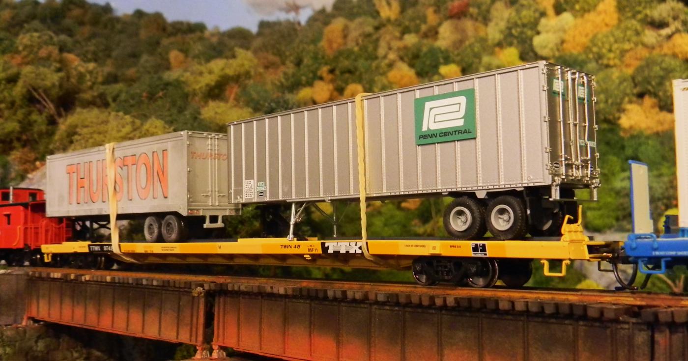

I was complaining about trailers falling off of flat cars last night and I was fretting about not wanting to adhere the trailers to the flat cars until I've had a chance to weather each.  Got me to thinking about what I could do in the meantime...
Rubber bands!  The idea popped into my head on the way to work this morning.  Doubled up a thin one around each trailer and automatically stabilized the flat and the load.  Aesthetically repugnant, but until I weather, it'll help avoid big disasters while running.  Cheap too!

necessity is the mother of invention.  I can actually see Penn Central doing this   Icon_e_biggrin

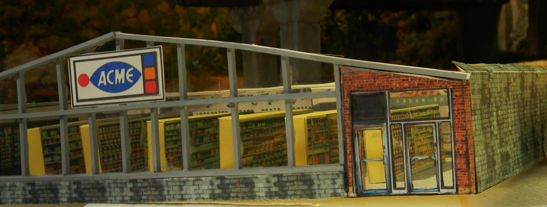

Shelf construction has begun on the interior of the ACME.  All cardstock, all build as I go.  I printed out some beige panels to build the tops, bottoms and sides of the shelving units, figured out how long and wide I wanted them to be, cut and folded and then stuck the photographed fronts of shelves from the Redner's I photographed last week.  I figure I'll need at lease 6 or 7 of these.  Then I'll also need some dairy and frozen foods cabinets, which will be black instead of beige.

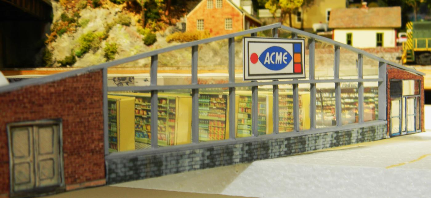

Busy week, but I'm getting a little time.
Built some more shelving unit and some of the produce/dairy/frozen food/meat units and installed same.  Interior's starting to look like a grocery store, which is what I've been hoping to mimic...
Gonna be kinda dark once I get the ceiling and roof installed, so I'm thinking of lighting up the interior a bit.  Next comes building the checkout stands and the produce/frozen foods bins.

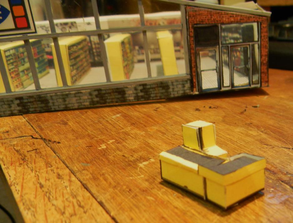

Got a rough prototype together for a checkout stand.  I spent a good deal of time between ages 14 and 17 bagging or ringing up groceries at Kinsley's Market in Tannersville.  There were a lot more tasks I enjoyed more there, but it was part of the territory.
I figured just getting the basic shape and size will probably be good enough for these.  Obviously I could have added a candy rack and a cash register, bags, etc.  I'm building 5 of these for the front of the Acme.
