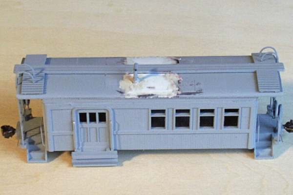

The one major "flaw", was on the crew car roof. The opening where the original cupola ( this was a caboose ) went, was filled using the original cupola roof, and I didn't get that piece in at the right height. I cut and added two pieces of 0.015" styrene sheet, one on each side, and then puttied the edges.
I use Squadron white putty, and dip the applicator in Testor's liquid plastic cement. It acts as a thinner for the putty, and gets it to flow into smaller cracks and spaces, to make a smoother "fill".
Now I have to wait for the putty to dry thoroughly before sanding and priming.

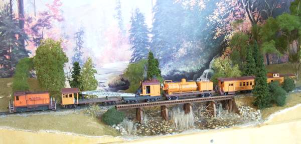

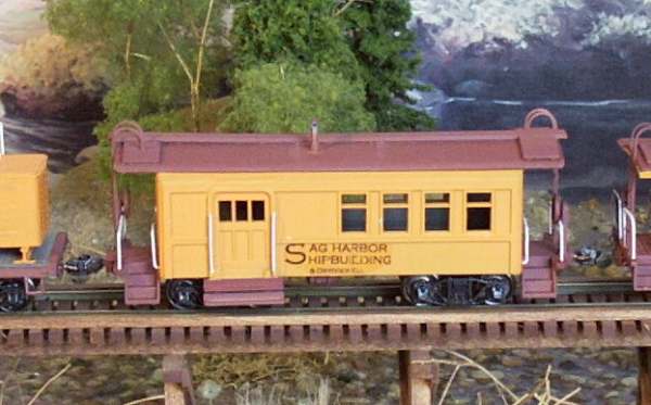

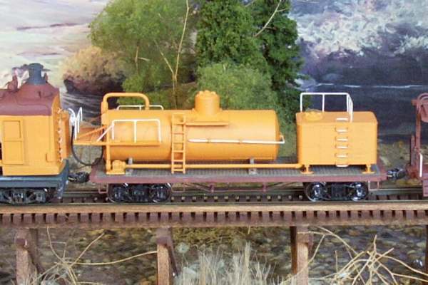

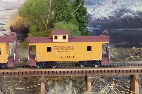

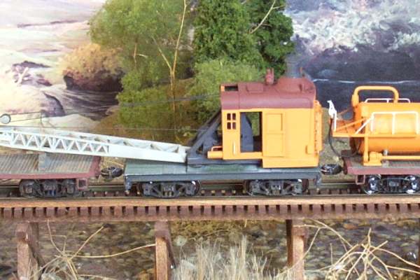

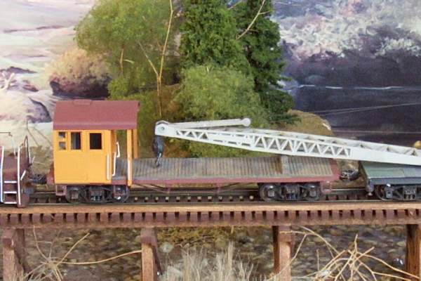

Paint!.......and some lettering:
I guess my Spring bash challenge is most correctly....a "work train".
the boom car.
The original start...., the crane.
The water and oil, "refuelling source", the tender.
The tool and riding car.
and lastly, the caboose.
The crane, and boom car, still need some details and additional painting, there's still some lettering that needs to be finished, weathering, and the trucks and wheel sets need attention, before this project is done..
