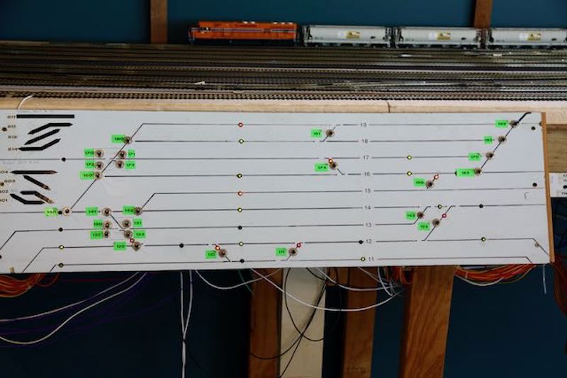

each Turnout will be able to be switched from the side of the layout via a momentary on toggle switch, as well as by the throttle and computer ......... eventually.
Below is my crude attempt to make a switchboard with these toggles switches in a busy area of the layout.
But they will mainly be just on the side of the layout near the turnout, like this.

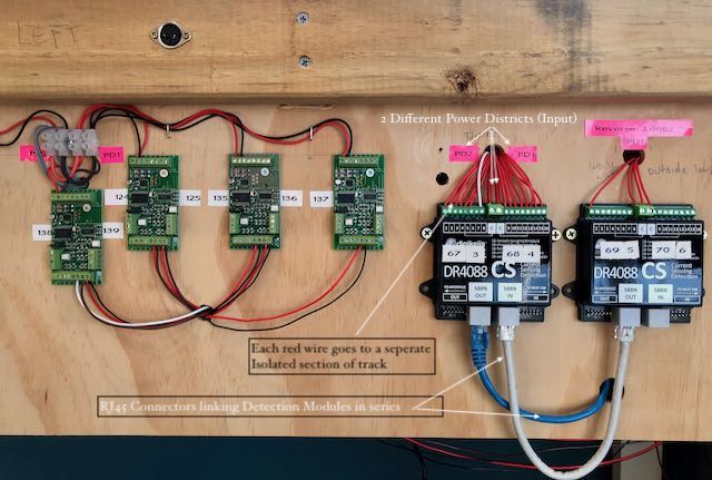

These 2 DR4088's are some of the Block detection modules
You just keep adding them in series to increase the number of sections that you need feed back from

For the software to see where each train is (occupancy detection) all that you have to do is isolate your layout into sections or blocks with insulated joiners. I made most of my blocks a bit longer than my longest  train. Then the drop down wire that powers the block is run through an occupancy detection module before going back to your DCC Command Station. Each of the off the shelf modules I use, can electrically detect occupancy of up to 16 different blocks, and that happens when current is being drawn from a block by an engine.
Simple wiring of the modules into the Layout. They can be added in series to monitor up to 250 blocks. (any more is another story for another time)

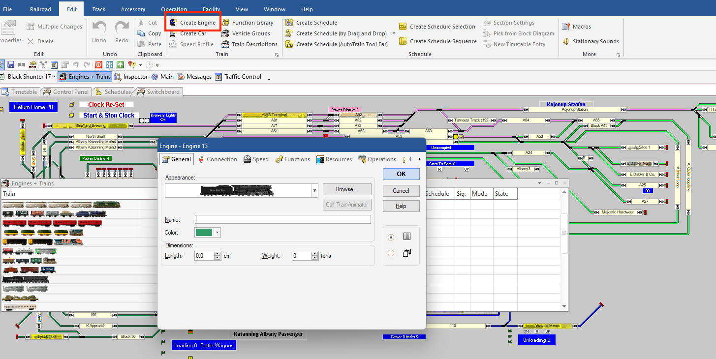

Each engine also needs to have its DCC address entered into the software.
Which is also simple.
In edit mode click on "create engine"
and Voila.  A new window opens for you to edit with a generic picture of a steam train. (later if you wish, you can take a photo of your own locos and insert here into the software)
 Then enter its DCC address.

I am impressed with the neatness of your under-layout wiring.
I have seen some other layouts with a nightmare underneath.
Thnx for sharing!
--Hillyard
