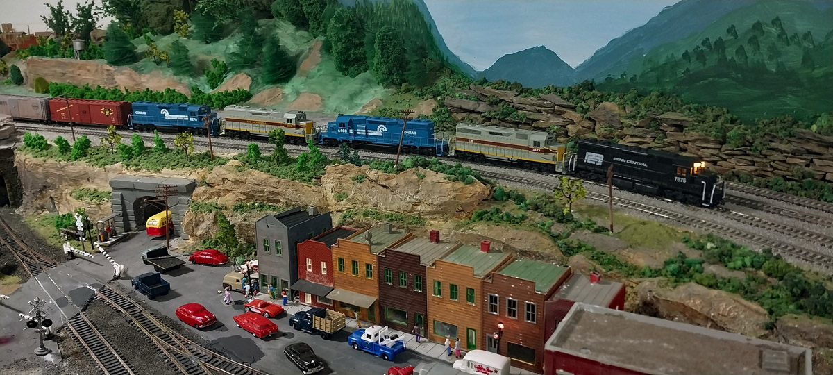

  Weekly Photo Fun 5/12-5/18/2023.
Posted by: Charlie B - 05-12-2023, 05:18 PM - Forum: Shutterbug area - Replies (3)

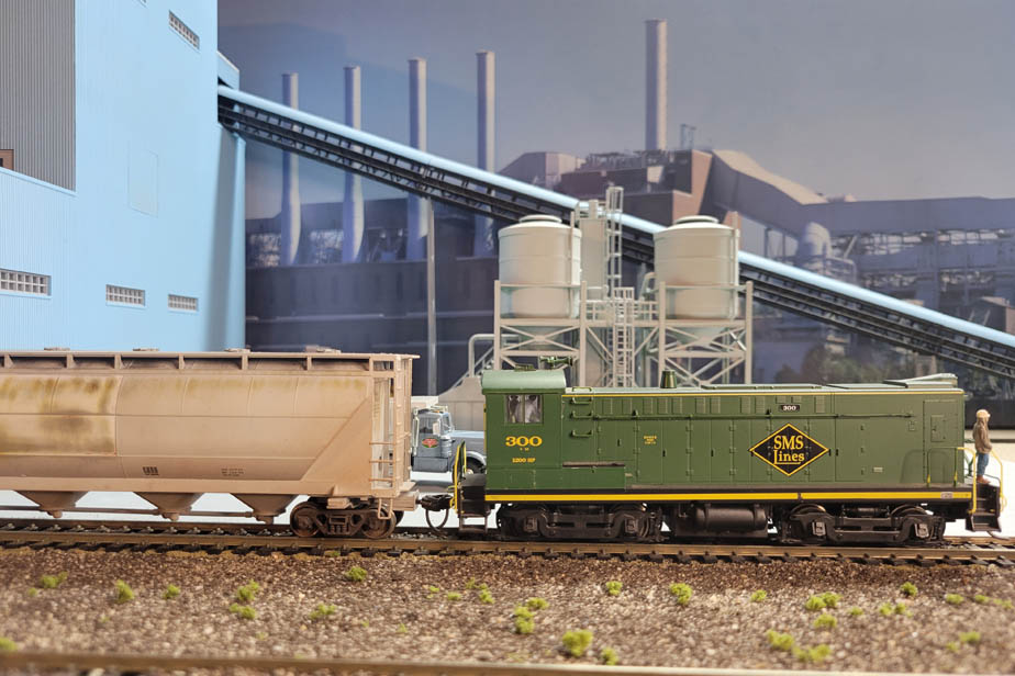

Just delivering coal for the generators.

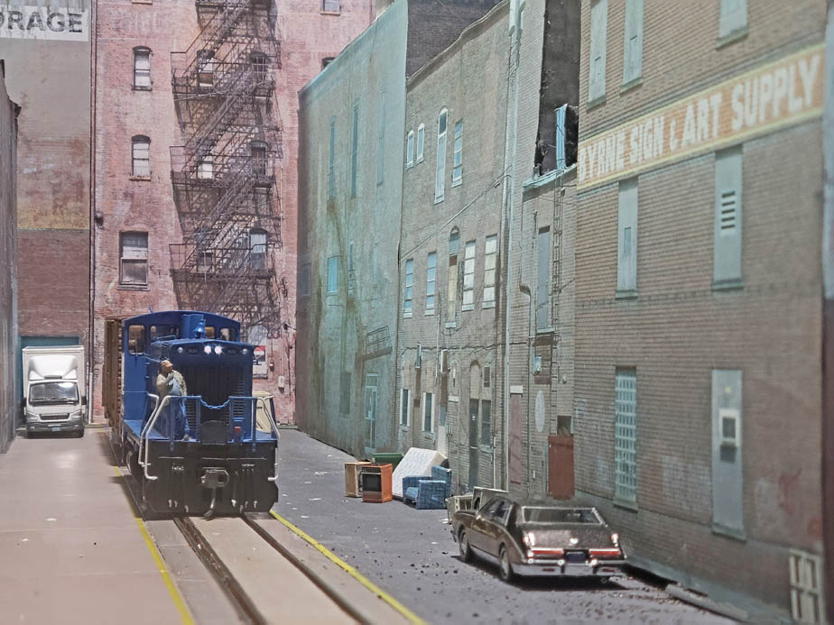

  Weekly Photo Fun 5/5 - 5/11/23
Posted by: bdw9535 - 05-05-2023, 03:31 PM - Forum: Shutterbug area - Replies (7)

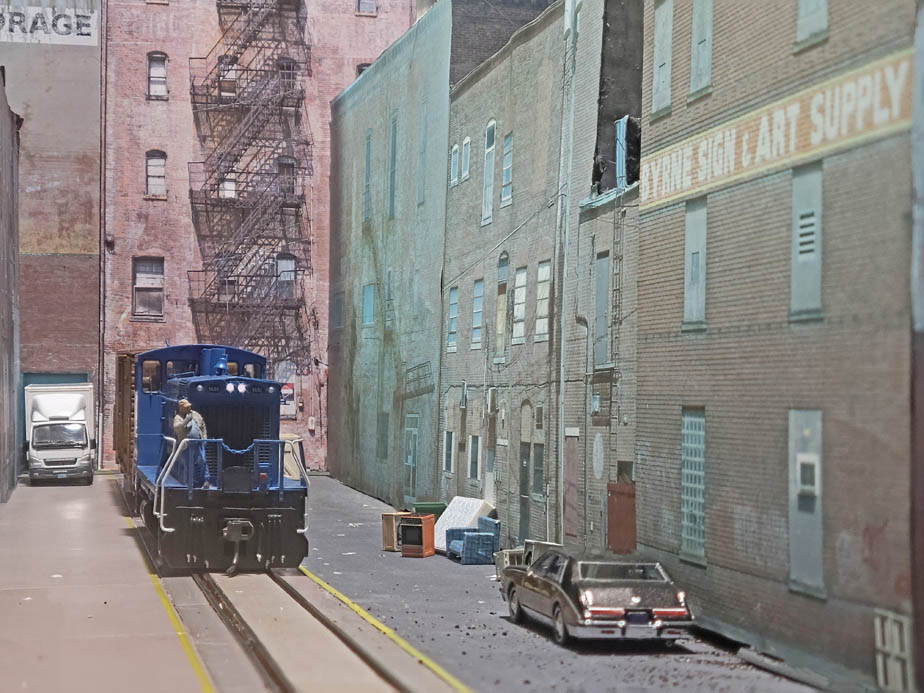

Conrail's stone train WPCA-51X.
