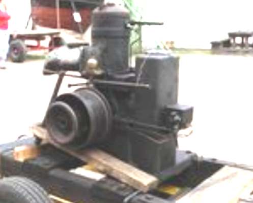

The photos below were taken some years ago in Caley Marina, Inverness with a very early digital camera , so arene't wonderful They show the winch on one of the very few Clyde Puffers still in use, VIC 32 - I hope they may be useful to you
[Image: puf8.th.jpg]
[Image: puf7.th.jpg]
[Image: puf6.th.jpg]
[Image: puf9.th.jpg]

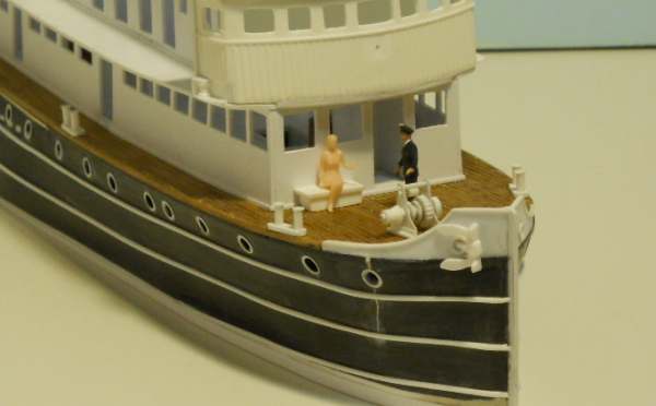

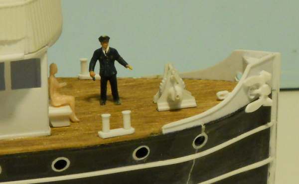

First, the anchor windlass, constructed.....
The anchor came from the "Firefighter", and will have some minor alterations.
The Bitts, were built up from styrene sheet, and rod. I chose a dimension of 12" for the height of the Bitts.
The small "positionable" gear, on the hand crank shaft, is moved clear of the large gear on the windlass axle, to allow the anchor to be dropped. It would be logical to assume that any motor, would engage that gear, when the hand crank was not in use, and be disengaged from it when using the hand crank. So the motor, and its clutch assembly, would most likely have to be
part of what is moved, to drop the anchor . . . . . . I'm working on that, and will probably mount the motor/clutch, on support rods, connected to the winch frame. ( or, just put a box over it....but where's the fun in that :?: Wink )

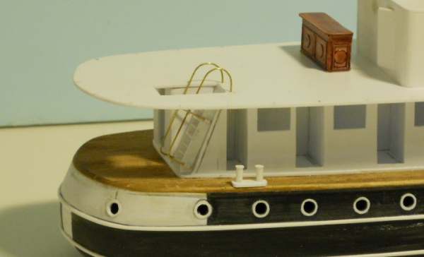

The aft ladder needs stain, and some final adjustments of the hand rails so it sits properly in place.
Finally, a shot of the full ship, at this point in construction.

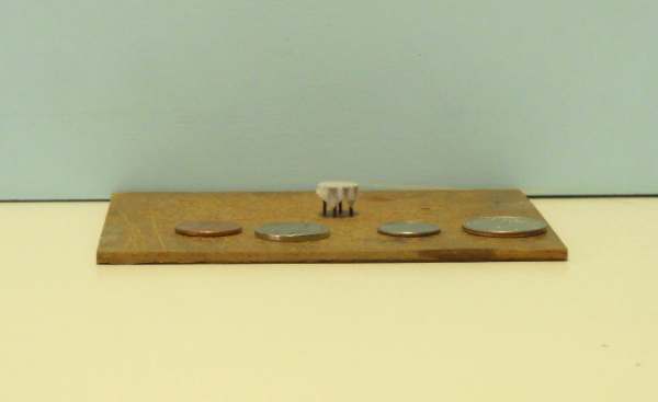

Built and installed all but one of the tables in the diner/lounge area. These shots are one of the tables, with some spare change for size comparison.
The Hull, and the "shelter deck", are in primer, and a few patches of putty. I'll post photos when the final coat of paint is on.
Once this is done, I can start installing the deck details, the remainder of the interior details, and attach the "Bridge Deck".
